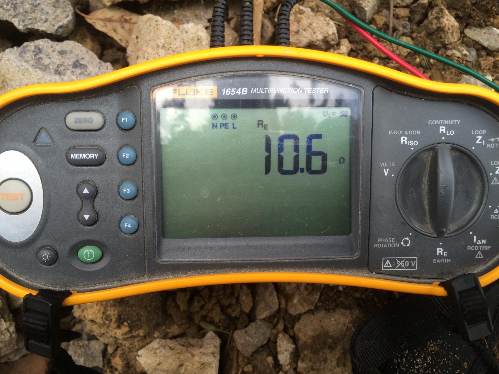

Hi,
As I mentioned last night, I was going to be putting the earth rods in for this summer house this morning.
I put 8 rods in, this was one stack of two, and two stacks of three rods.
The readings from the two that were 3 rods deep were around 10 Ohms per location, and the two rod stack was approx 17 Ohms.
I tested the first rod at approx 10 Ohms, then connected the second rod to the first which was 17 Ohms which them reduced the total down to approx 6 Ohms, then connected the third rod which was 3 deep and that bought it down to 3.2 Ohms.
So the Ra that I achieved today was a respectable 3.2 Ohms
All rods were connected together with 16mm earth.
I am going to go back next week and bang in another couple of piles of two rods so another four in total because I want to get that sub 1 Ohm reading.
Anyway, what do you think, 3.2 is not bad is it!!
Reading from first rod: 10.6 Ohms (3x 4ft 5/8" Rods)

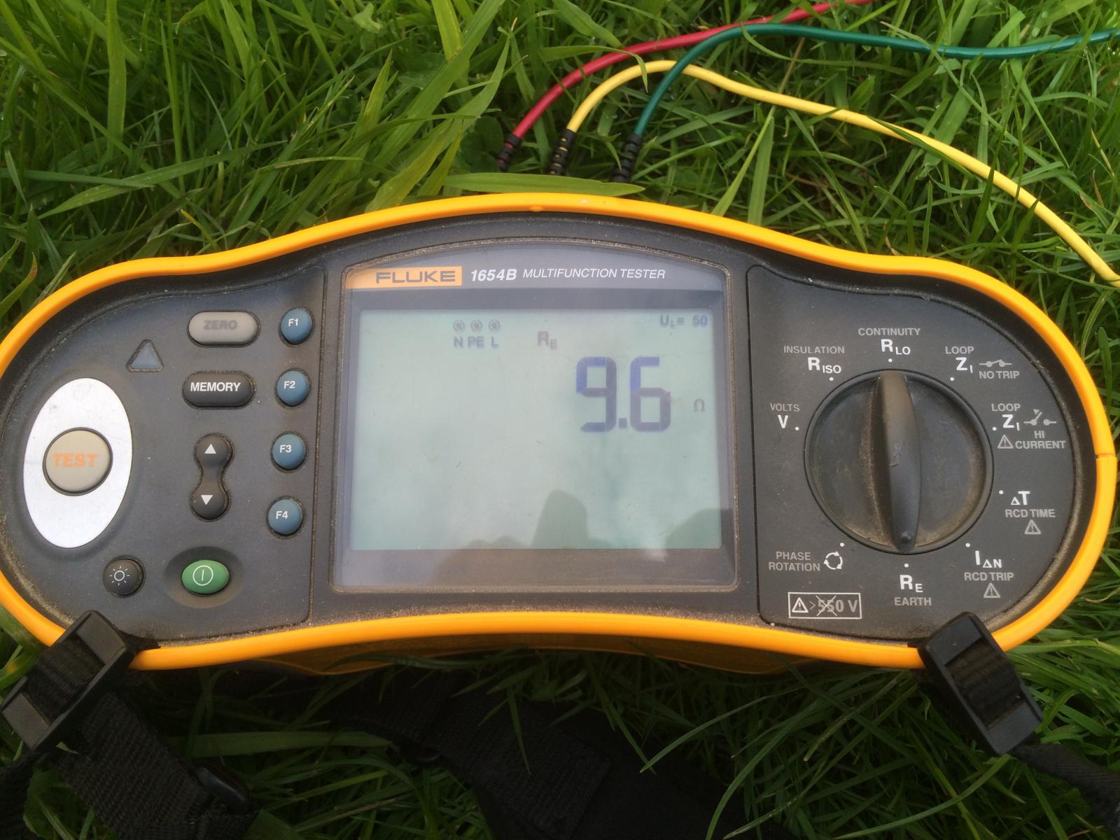

Reading from third rod: 9.6 Ohms (3x 4ft 5/8" Rods)

Reading from all three rods connected together: 3.2 Ohms

I would say 3.2Ω is a pretty good reading, 71A fault current enough to trip a 10A MCB.
Pretty close to the resistors in parallel results actually which is interesting to know.
Thanks for putting in the effort to give us some feedback.
I think I'll put two more locations in and end it there, I bet each will knock an ohm off the figure.
it about killed me off beating them in with a lump hammer!
By the time the group has settled the reading will have got better as its really only the bottom rods that are in are touching the earth as the others are flapping round due to the couplers.
The first one was easy, the second was a little touch, but the third rod was the killer, the deeper you go, it just gets sodding hard work.
I need to achieve a higher fault current really as 71A is pants, just looking at the time current tables in the BYB and max zs etc.

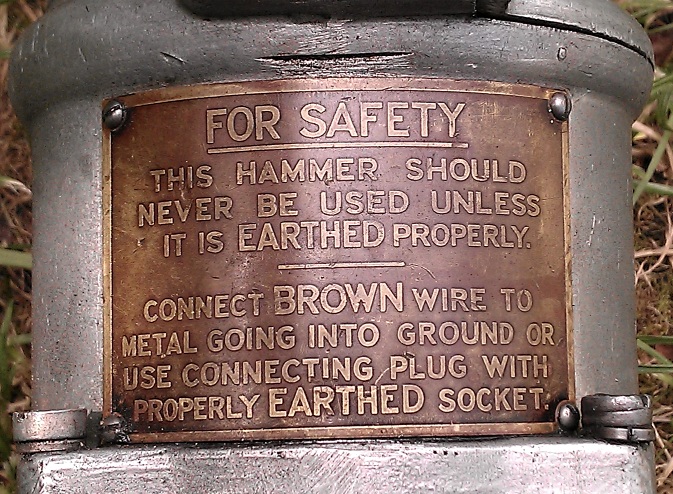

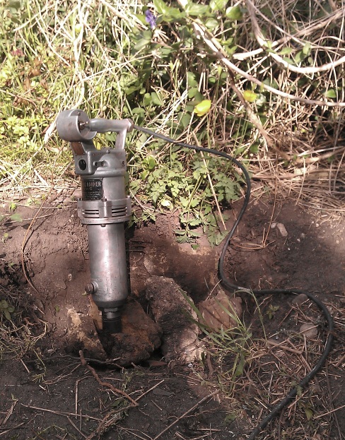

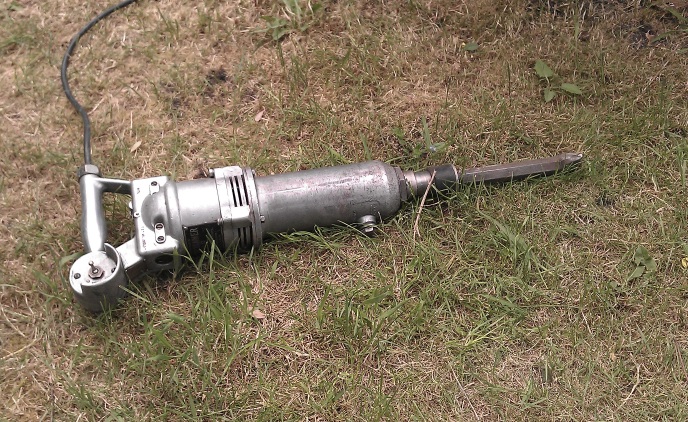

I could try putting another on the top of them, I could do with someone holding the rod so i can hold the hammer with two hands.
I could try putting another on the top of them, I could do with someone holding the rod so i can hold the hammer with two hands.[/QUOTE]
or one of these :D much easier
[video=youtube;vvCZvNj8H30]https://www.youtube.com/watch?v=vvCZvNj8H30[/video]
you tried something like this? might help
[video=youtube;0sLv4LLVPbA]https://www.youtube.com/watch?v=0sLv4LLVPbA[/video]
I'd need an SDS max bit wouldn't I? and I could rent a drill to do it, presumably an SDS max drill would do it or would I need something bigger?
thats fine, prob normal sds would do but might take longer, but vid below is sds max demolition hammer
[video=youtube;VJYhHZYu_4g]https://www.youtube.com/watch?v=VJYhHZYu_4g[/video]
i just get glennsparks to come round and snarl at the rod. the rod then drives itself in.:uhoh2:
