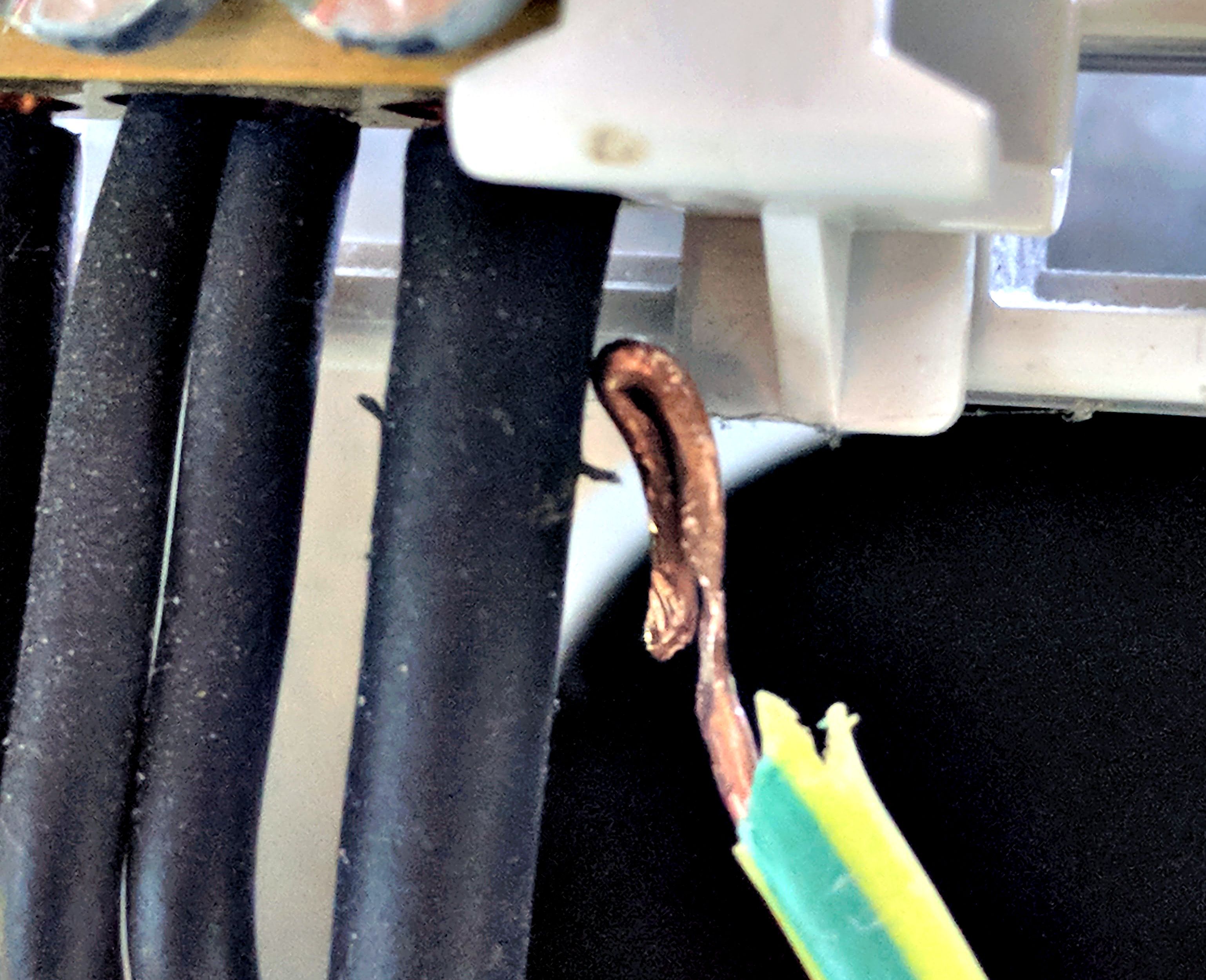

I imagine its cable size dependant? Anyone have a quick table i can print and laminate?
[/QUOTE]
It's very cable size depentent. CU manufacturers are (IMO) remiss not to always point that out clearly (some do). OK for bus bars and fat cables, but applying the "recommended" torque into a screw-down N or E terminal on domestic lighting can easily do this (pic). I've been called out and have come across CU with cables snapped right off. I often take the time to trim and re-dress the ends where I see this (which is quite often nowadays with the promotion of torque drivers). Flat torque driver.jpg
