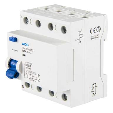

I am helping a local football club who are having some issues with Zs being too high on the submain. They have the supply Henley blocked into a 100amp TP switch fuse (BS88-2) which then feeds a 35mm 4 core SWA 95m to an isolator in another building which is being built. The Ze at the incomer from the DNO is 0.27 (TN-C-S) and the Zs at the isolator is 0.47. This exceeds the max permitted and from my calculations to get it within parameters, they would need to run a 70mm separate earth to supplement the current earthing. Given the higher Ze (although it is within limits), only leaves around 0.07 for an r1+r2 reading, and given the length of run doesn't leave much room to play with.
This will be extremely costly so I wanted to see if there were any other options we could explore first.

Add a delayed RCD to trip in under 5s

MCCB RCDs come in seemingly endless varieties, but something like this in place of the switch-fuse is a possible solution as Julie suggests:
Not cheap either, but with up to 5A threshold and 1s delay you can get reasonable selectivity with some final circuits not on RCD protection but just smaller MCBs (e.g. any MCB that trips on magnetic threshold due to hard fault will be ignored, so long as you don't get many amps to earth without anything noticing).
This is probably cheapest option, as Julie suggested adding RCD to switch-fuse:

Personally, I would go for the mccb option, as down the line you can use mcbs etc to achieve ADS, without the need for rcd functionality. This could have significant advantages on particular loads or essential services, which are often needed in industrial or similar situations.
It also allows stacked discrimination, so further sub-boards could be installed downstream of this one under consideration.
I mentioned the RCD option of course because it is a cheap as chips in comparison, but doesn't have the flexibility that may be needed.
I would imagine a mccb would be a significant cost saving on running additional cables after the event.
