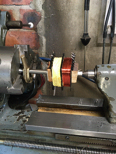

I have a Transformer, that needs a rewire on a Secondary windings, the wire that was on it, was a muti-core wire 9 strands, (0.06mm x 9) ( each strand enameled ), soldered together at each end, and laid on top of the primary winding with 175 turns, with a copper tape between the primary and this secondary .
Question: This multi core (Litz) secondary winding is supposed to have a output of 420v, but with only175 turns it will not equate to 420v, but if all the strands of the Litz was classed has a single turn then that will equate to 420v !.
I just don't get it .
Transformer outputs are:
Primary: 0: 0 – 240. V, P1,P2,P3
Secondary 1: 0 – 420. V @ 3 mA , S3
Secondary 2: 0 – 6. V @ 32 A , S1
Secondary 3: 0 – 12. V @ 400 mA, S2

To work out how many turns are needed for the 420v you need to know how many are on the other windings.
So if the 240v winding has around 100 turns, then 175 would be correct etc.
Doesn't stack up to me (transformer lamination joke?)
You're thinking 9 x 175 = 1575 turns might theoretically give 425 volts (if the litz wire was all one long single strand?)
That means 0.27V per turn, so the primary has 888 turns?
(Your 175 turns of existing litz would give approx 47V)
If that's the primary on the right in the lathe, that might be more than 888 turns?
Do you know the volts per turn?
The spec you show says 3mA for the litz winding, but its capable of much more current than that.
And why litz? That's for high frequencies - skin effect conduction and all that, not for 50Hz transformers?
Perhaps Lucien can throw light on why litz might be used in a traditional mains transformer ?
I don't understand how you could get 425V from so few turns. Maybe someone has already modified it??
and final comment - nearly double the number of turns wiil be needed for the 425V winding than already there with the primary, (shown as on the same bobbin as the primary) so you might expect it to end up pretty full!

I am not sure it's litz for high frequency, it could also be for convenience.
The way to check is just wind 100t - then energise the primary - if there is 240v applied and you get 240 on this test winding, then you need 100t x 420/240 or 175t for 420v
If you get a different voltage - so 100v output for 230v input just recalculate accordingly.

Unless you have the core cross section - assuming 1wb/m^2 flux density the volts per turn will be 1/4.44 × f x x-sectional area ( x flux density if not 1 weber per m^2)

Hi
Thanks all for your replies , I just really want to know how can the spec say that the secondary winding I have to do has a 420v output, when the original winding had 175 turns of Litz wire ( 9x0.06mm dia ) each wire individualy laquered and soldered together at each terminal output lug .
I have spoken direct with the makers Trans Tronic ( UK) to confirm that .
I am not interested in the primary winding that is ok, but I had to remove the secondary winding ( Litz) to get at a thermal fuse that was under the first layer of the primary winding, have sorted that, now I need to replace this secondary winding, but am confused has to how it can give 420v !, maybe I am missing something here .
ps: The primary has roughly about 800 turns, 399 for the first layer !.

Wow you've got some serious heat damage to the PCB there. Are you actually hoping to repair that!?
Just to be clear, as you know, the volts you get out of a transformer winding is proportional to the number of turns in the coil, not the number of strands in the wire!
So the 175 turns you mentioned are never going to give 420V
Have you got the right information for your particular model/version?
Note the print on the diagram for the 420v is in a different font and size to the rest - did the manufacturers do a change?
Or has someone been at it already?
Just as an aside, one can generate higher DC voltages with a voltage multiplier without having to have a high voltage transformer, but that's presumably not what is going on here.
I have absolutely no idea why there appears to be such a discrepancy between the transformer you have, and the information you have on what it is supposed to be.
Can you get hold of, or find more information on, the 'correct' transformer?
And before you spend too much time on the transformer issue, check out what's happened to the pcb, because that looks a real mess to me!
Without knowing what the exact placement in the circuit is, we could be being sent in completely the wrong direction here.
If it is the supply transformer - I.e. on the mains input then it would give around 50v not 420v with 175t cf 800t primary, if this output is then used to generate 250/500 vdc it would need a voltage multiplier of ~3/6 (plus the 1.41 for rms to peak) which is reasonable.
However if it is actually an output transformer then it could be the 240 winding is the output and the 420v 175t refers to the winding which will generate the ~500vdc after dc conversion on the normally 240v winding - achievable as the frequency would likely be several hundred hertz rather than 50.
Ultimately this transformer looks like a specific design for this product, it may use a standard former normally marked and wound for 240v/420v, but actually wound specifically for the tester with totally different ratios from that implied by the drawing.
