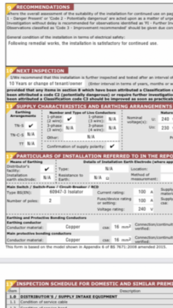

These flats was built 50 years ago and it’s only come to light there is not a decent earth
My electric cert is 3 years old but it is only when UKPN done an earth test on the block it’s found it’s not adequate
I attach a small part of my test cert
Yea thats not TN-S. Historically incoming metal services were at times used for an earth. But they've ticked the wrong box, that's not TNS. You need to honestly get off here and get some electricians in asap
