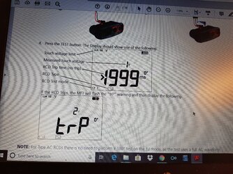

I am in the process of hunting for another difficult fault (intermittent tripping RCD, absolutely no faults showing on any circuits and only 2mA fault current in Main earth).
My question does indirectly relate to this... perhaps.
When testing the RCD with my megger 1731 I am not getting a reading in mS. All I get is 'trp'. The RCD trips, but it does it so quickly and just states 'trp'.
The above was testing at a socket so I tried testing at the RCD itself and got the same.
The RCD is protecting 3 circuits, 2 socket circuits and the cooker. When i test at the RCD with the 3 breakers up the RCD trips and says 'trp'. When I switch off the cooker breaker and test I then get a proper reading (27mS). When I switch the sockets off and the cooker on I get a proper reading also (27mS). What does this mean?
Reading through the megger download does not give any useful info. It just says (under RCD testing), "if the RCD trips it will show 'trp'!!!!! (see pic below)
I suspect that you have a higher leakage than you think.
this is causing the rcd to trip almost as soon as the current is starting to ramp up from the meter.
have you tried IR testing the oven and grill elements?
Hi - 2 thoughts as per above really - check you’ve set the test to AC (or what have you) and I think it’s tripped at less than 15mA, a fail. So maybe try a ramp test and see.
The first test the MFT does is the 0.5 IΔN test (15mA in this case) to prove that the RCD does not trip at that current (which is must not, if it is in spec.) But when the circuits are live, the test leakage is adding to the existing leakage, taking it over the 15mA and causing a trip. So the test aborts alerting you to the fact it tripped when it was not supposed to.

I was assuming it was an 'auto' test where it does 0.5x, 1x & 5x in sequence, which is how I usually use mine. I think this will display TRP if it trips on 0.5x. If you were on the fixed 1x range then I expect the tester produces a small amount of 'leakage' while synchronising its test current injection circuit to the mains waveform, and even that is enough to push your RCD over the limit.
A measured current in the earthing conductor means very little, this kind of current can be measured on an installation with no faults at all.
To measure earth leakage you need to measure the imbalance between current in all live conductors, this is done by clamping around all live conductors at once.
Those test results suggest that the RCD is fine, but that there is earth leakage on both of those circuits which is biasing the RCD to trip at a lower current than it should.
