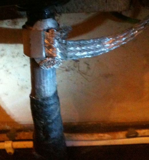

Hi folks, about to do a domestic PIR and observed during survey that the main earth conductor is flat braided copper. Didn't measure but from photo it looks either 6 or 10mm2 CSA. Assuming that Captain Adiabatic tells me it's inadequate, when I call on supplier to upgrade, will they most likely replace with larger braid or put on a new sheath clamp with appropriate round cable? Many thanks, SW
Did you get the measurements of it?

No but it's either 6 or 10mm2. But back to my question, does the DNO replace with new clamp and round cable, or simply fit larger braid?
It's the DNO property mate and all you can really do is call them, but I know that if you have a good Ze value for it they will do nothing.
If I got a good Ze value, then I would basically leave it alone, You could note it, but it's not part of our installation so as long everything the customer side is ok then your good.
It may even be an old DIY TN-S done by a bygone sparks

A 16mm2 earthing conductor is not strictly required if the adiabatic equation allows it. But, I had not appreciated, per malcolm's comment, that this may be a DIY TN-S, in which case, the DNO would state they are not supplying an earth. What would happen then if there was an incident (this property has no RCD). If I'd done a job and walked away, yes, I probably be liable.
