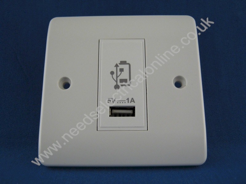

Hi All.
Advice required/regulations on installing a single USB socket without mains socket - see attached picture, in a bathroom.
Any thoughts/responses or ideas will be kindly appreciated.
Kind Regards.
Jag.

You know that was at the back of my mind, I think you are right. However...people will be tempted to get a lead and charge up while having a soak just because it is there. I can't help worrying about that especially about a proper isolating transformer to BS61558
Are we getting worse as a nation or was there always a section of society bereft of any common sense? I bet this plonka would have been one of the idiots driving round with said phone clapped to his ear.
Just had a quick look on manufacturers website. No mention of isolating transformer.
But it does say MM515 is internally fused, tested to withstand at least 8kV surges. It may therefore be connected directly to a standard ring main with the addition of a FCU.
I certainly would not fit one of these in a bathroom.. why would you??
