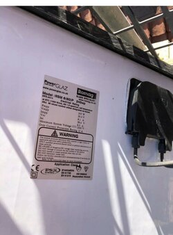

I have made a good deal for a set of used 16 panels a 4kw two sting inverter and various isolation switches.
I am not sure yet if I can get all 16 panels to fit on my roof or the way the panels are to be connected to the inverter.
I don't have optimisers but I have a clear view of the south.
if I cant get all 16 panels on my roof will it affect the inverter?
do I need optimisers?
what is the best sequence from panel to panel to each string on the inverter?
I will upload the type of panels once I take photos
the inverter is a solar river 4400tl

I forgot to ask if its better to have optimisers which ones are compatible?thx

DNO will need to be informed for a grid tied system.G83 in this case. Also if using less panels and they are all in same orientation, check max string input voltage on inverter, you may be able to run all the panels in series. More efficient as will get to start up voltage level earlier than two parallel strings.

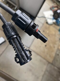

I want to make sure when I get around to wiring the panel to the manual breakers then to the inverter I get it right.
is the cable with the red seal the positive? shown in my photo.
this goes through te manual breaker to the positive on my inverter?
when I tested the panel with a multimeter putting the red lead in the red sealed cable it did not show a minus reading.
