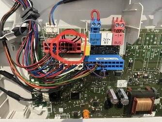

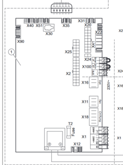

I recently had a boiler service and they mentioned that the wiring looks wrong. Boiler otherwise in good condition. I've seen similar threads and not sure my case matches so here goes. Previous owner installation so not sure who did the job.
System setup:
Myson controller for UFH and a Center controller for rads and HW. Valliant ecoTec plus 630 boiler. The rads upstairs do not have a stat and seem to be only controlled by programmer.
Symptoms:
Seems system is constantly calling for heat as boiler rad icon always displayed. During the night in particular the boiler turns on/off constantly.
Now, I've tried removing the 24v link from the boiler PCB and the UFH works fine, however the Center controller for Rads/HW no longer manages to call for heat (despite programmer on).
Looking at the wiring, it does seem like the switched line from the programmers to the boiler are connected together.
Attached pics of boiler PCB and setup. Happy to provide more details at request a d and help hugely appreciated.

Adding PCB wiring as don't think it uploaded

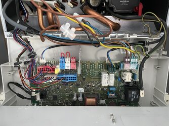

Can you post a picture of the whole PCB showing the mains and 230v RT connections
Thanks for taking a look. Hopefully this is better? Tried separating the cables a bit

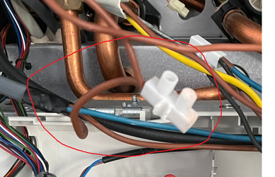

Is this a T&E with the earth sleeved brown going into the connector block?. This would be a definite no no
Yeah looks like it. Took out the tape to check. Hard to confirm at the programmer end of this use of earth line continues. Any thoughts on heating issue other than bad practice wiring from installer

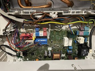

That made me take a closer look at the setup, this is what I found, hopefully useful:
1. HW call from programmer only goes to immersion tank and valve. Does not go to boiler
2. That connector block you highlighted goes live with CH or UFH call for heat, however, RT 230v on the boiler only goes live with UFH call and not with CH call. This is without the 24v link in. Seems time that it should be this cable going to RT rather than the existing one. Any reason for just UFH to be calling for heat in my setup? I was surprised that HW doesn't so maybe also reason for CH not going 🤷‍♂️
3. Also noticed this odd link on the PCB itself which I have no clue why it's in
I have no idea why you would make that connection/ joint in the boiler when the boiler operation is controlled by the RT 230v terminal. The 24v link should be in this is for low volage control of the boiler
For info taken from the boiler installation manual
The PCB is possibly used in other Vaillant boilers ie combi's and these terminals may have specific uses / control functions that are not used in a system boiler so are linked out

As you can see from this wiring diagram it shows X100, the 24v=RT connector linked out

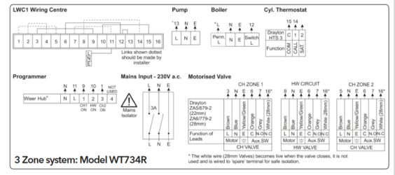

In an ideal world this is how you system should be wired (closest diagram I can find online) your boiler has an internal pump so only the SL line to the 230v RT terminal on the boiler is needed
Valliant ecoTec plus wiring advice 1665843959477 - EletriciansForums.net
This diagram uses a 3 channel programmer but could be adapted to use 2 programmers as you have got
From your pictures I'm not sure if you have a wiring centre for the heating controls but for an upgrade of the programmers and simplification of the wiring I would suggest https://www.draytoncontrols.co.uk/product/wiser-thermostat-kit-3-0

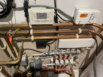

All the actuators seem to fire directly from the wiring center or junction box near the controllers.
The wiring centre is exactly what it is all the motorised valves, thermostats and the programmer is wired through it and if you look at the the S plan diagram it is the motorised valves that call the boiler for heat on the SL connection and as the system cannot pump against closed valves when the programmer and stat call for heat the valve opens and the switch closes to fire the boiler and pump
