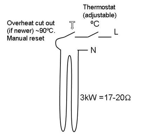

In order to test the thermostat and element you would need a test meter, one that can do continuity, resistance and voltage measurements.
Verifying/confirmation if Horstmann Economy7 Timeswitch needs replacing. Immersion heater - EletriciansForums.netwith the power off and water cold test continuity from line to neutral, should show 17-20 ohms, if it is not continuous at all move on from incoming line to the other side of the thermostat and then onto the element itself. leaving the other probe on neutral. where continuity stops is the "off" item.
If the resistance of the element is less than or more than 17-20 ohms there is probably something wrong with the element.
If this testing is comprehensible to you then you should be able to move on from there and test independent items, if you are not sure how this works then it is best to get more trained assistance.
