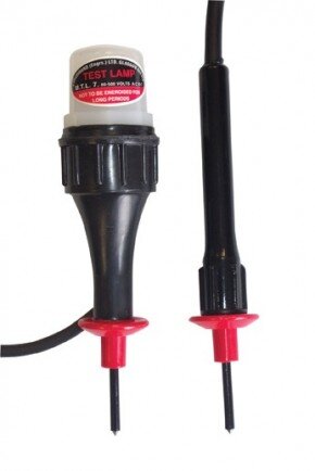

After installing some LED fittings in a bathroom and disabling an electric shower circuit I carried out a check on the whole installation. All fine until I used my Di-LOG probe to probe the switch plate screws to check that I had not pinched any live wires in the light switch back boxes around the house (not sure what made me do that?). One switch lit up the voltage present light so off it came. No trapped wires but using my Megger MFT1730 I see around 20 volts between the earthed back box and the switched line when the switch is open, 244V when closed. Disconnected the cable from the ceiling rose and the switch and carried out insulation tests between all conductors, everything >999M. Re-connected and the 20 volts was back.
Does anyone know what I'm seeing/experienced this before and is it real? Or should I just not be so inquisitive!
probably induced voltage. try using an analogue voltmeter. it'll probably disappear. was the switch in question 2 way?
any cables running in proximity of your switch cable. as i said before. try an analogue meter. the lower input impedance will drain away any stray voltage.you may see an initial "kick" of the needle should then settle at 0V".

I know I can buy this via the web but thought I'd try some of my local distributors (Edmundsons, Senate, CEF) yesterday. No one had heard of this item let alone stocked it although they were all keen to show me fine collections of hen's teeth and rocking horse ****! "What's an analogue voltmeter?" one said LOL.
