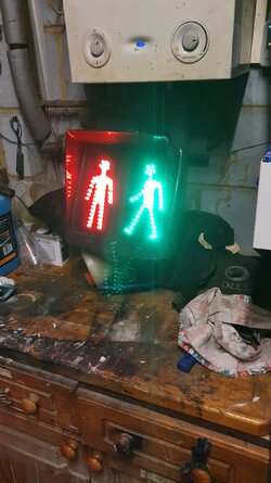

At this stage, it switches on and off with both the Red and the Green men lighting up together. What I would like to do is fit a module that will cause the Red and Green Men to light up individually for random periods of time as if it was fitted to the street furniture originally. Does anyone have any ideas as to how this may be achieved?

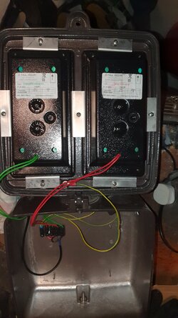

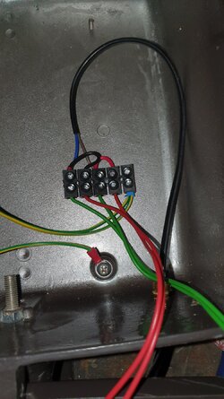

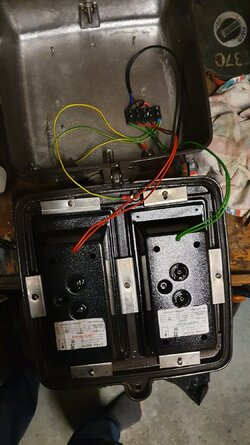

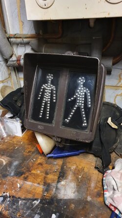

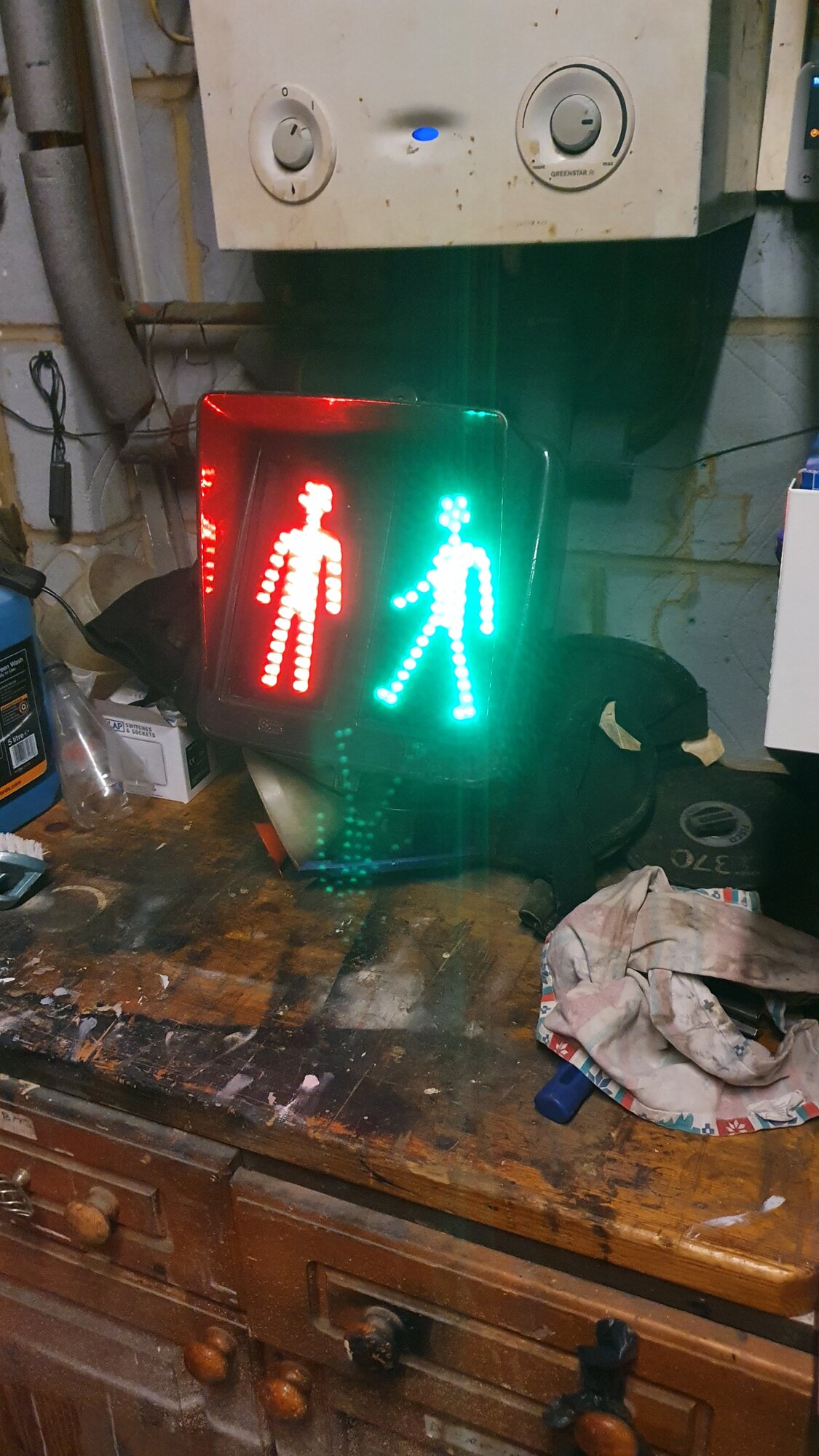

Okay @DPG here we go, I have added them as URL's to Upload the image directly to the thread, any probs let me know.
If you have any ideas further to your previous comments I'd be interested, ie how you may think that the unit works and how the possible Arduino would be installed.
Walk, Don't Walk-Off
Walk, Don't Walk-On
W,DW Inside All
W,DW Inside Power to Choc Block
W,DW Inside Back Of Light Units

So, are those units running at 230VAC?

I'm sorry I don't have a clue. Saw the sign, 10 euros on a street boot fair stall at 8 am in Paris and dragged it around for the next god knows how many hours. Weighs a ton.

You've got it powered up in one of the photos. What voltage have you supplied it with?
