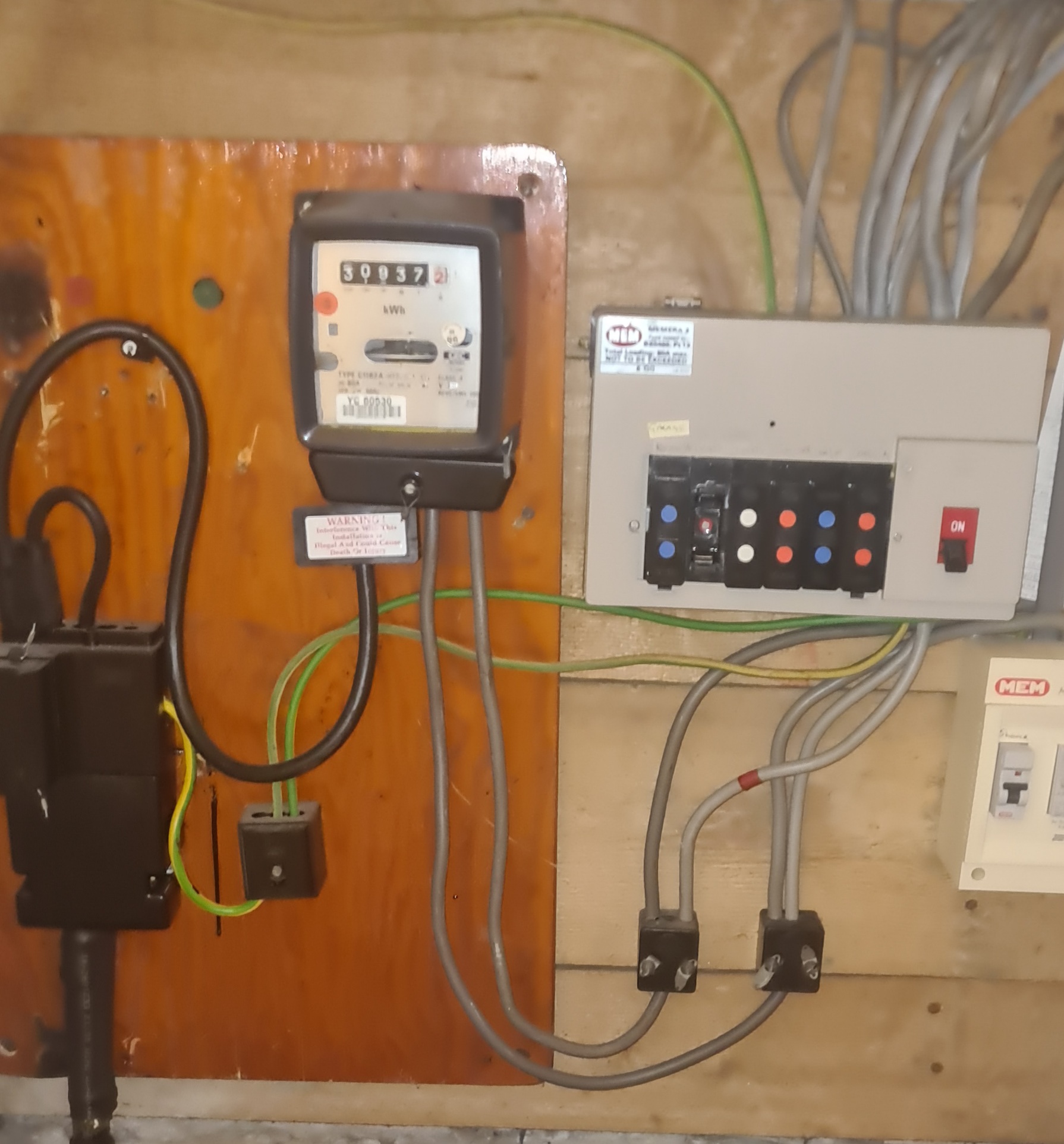

Do you know what the £1000 was for? Im in Northern Ireland also and it sounds expensive, but it could include more work/upgrades than only upgrading the consumer unit. RCD protection is a worthwhile upgrade and a must, especially when situations like this can arise. If you put a couple of pics of the fuse board etc on here we might be able to advise.
This is what we're working with. Don't know what he was referring to I'm case of the £1000. Was checking out RCDs today and also came across RCBOs. Is there any need for those or are RCDs ample?

This is what we're working with. Don't know what he was referring to I'm case of the £1000. Was checking out RDCs today and also came across RCBOs. Is there any need for those or are RCDs ample?
RCD protection is like a blanket protection, only issue is with a fsult on one circuit you will loose any other circuits protected by that RCD. RCBO is individual RCD and overload protection for each circuit. This is usually more expensive, but in my opinion is the best option and way to future proof your installation. Your main board doesn't appear to have RCD protection which would be a concern. Although the shower currently does, it may be wise to integrate it into your new consumer unit also if you do decide to go ahead with it.
I sincerely hope that 30A fuse carrier (2nd from left) is not lights and still 30A!
It was a 30A fuse that blew earlier actually. The board may have been mislabelled as we discovered today also. If an RCD pops or trips or whatever the terminology may be, do you just replace a fuse/the fuses it is responsible for or how does it go?
If something trips you just reset it using the little leaver. No faffing around with wire or replacement fuses!
Looking at your setup there are only 7 circuits (6 in the CU, plus the extra shower) and these days RCBO are only around £20-30 more than MCBs plus you save not having two RCDs as well, so I suspect going all-RCBO is only around the hundred quid difference in parts.

So when poster above mentioned you'd lose any other circuits connected to that RCB, that just means your electricity would go off throughout the house and the person would be protected. You risk damaging some appliances but you just remove the short circuit and flip the switch back?
The older arrangement has one RCD feeding typically 3-6 MCBs (depending on the board size), so the MCBs provide over-current protection, while the RCD provides additional shock protection. However, if any of those circuits has a fault to earth the RCD will switch off all of them.
So you are protected but it might mean lights going off on a faulty kettle, etc., which is not ideal and possibly a bit unsafe. Also you have a harder time if a fault develops in terms of finding out just what is causing it.
With RCBO each module has both the RCD aspect for shock/leakage protection and the MCB aspect for over-current protection.
Stuff going off does not usually damage things, though clearly it can be bad news for someone using a PC or similar at the time.
In most cases you won't know what caused the fault, unless it happened the moment you plugged something in or switched something on. Unlike fuses when you should never insert them live, you can close a MCB or similar on to a fault. You will get a bit of a surprise, but they are designed to be safe at the sort of fault levels you see in domestic power supplies.
Bigger faults on stuff fed from 13A sockets usually takes out the fuse in the plug, but often it also trips the MCB as well (whereas usually a 30A fuse will be totally selective with faults on 13A or lower fuses), but resetting is not too difficult.
