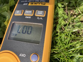

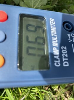

Since the recent horse deaths I have put a Fluck clamp meter and cheap one on the LV pole earth wire at base of this xformer. very intermittent readings showing as high as 90 milliamps. .20 mill is death. 4/5 is rapid weight loss.Both meter show within 1 milliamp
For humans 20mA is not death, in fact the usual protection RCD trips at up to 30mA as it is below the threshold for fibrillation and being able to let go. See the IEC graph of electrical effects here:
Having said that, there is some evidence that animals are more sensitive than humans for like-events. There was once case of lightning hitting near a camp with children and the fatality rate in pet dogs sleeping along side them in the tents was about double that of the children.
But more fundamentally you are measuring the current going in to the ground, not what is passing in to any animals in the region. That is the whole point of having earthing structures buried deeper in the soil to ensure that someone walking in that area is not killed during a fault event that dumps more than 100,000mA!
As you appear to have a clamp multimeter (picture only shows a bit of the meter), I presume it can measure voltage so try putting in two spikes (e.g. tent peg) 1m apart in a line away from the pylon and measure the voltage difference between them. You can use different separations but as step-potential is measured in V/m it is simpler if the interval is 1m.
