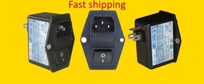

I m doing my first build of an arcade machine. At the back of the arcade cabinet will be an IEC socket for mains power. Inside the machine I then need to split the electrical wires so that the one socket can power both the power supply for the console board (standard jamma power supply) and the LCD monitor. The monitor and power supply both take 240v AC mains power. I was told I could just strip back the kettle lead for the monitor and crimp connect the wires to the power cable for the power supply and wire them both into the back of the IEC socket together. Is this safe if both appliances are rated for the same voltage? To be honest I d rather use a junction box or something but not really sure what type of need or how to wire it exactly. I have slight electrical experience but still basically a noob.

Here is a picture of an arcade power supply. The bottom 3 connectors are AC and ground, the upper connections are 12v+ 5v+ ground etc. Here is also as picture of the back of the IEC socket I'm planning to use.

The IEC socket had a built in EMI filter and is fused at 6a. I've been told ideally arcade machine should be fused at 5a? The monitor draws 1.5a and the game board that the power supply will be running draws 5a (I think)

With regards to the fusing, it depends entirely on what is being connected and the ratings of the components involved. So if your monitor requires 1.5A and the PSU for the board requires 5A, then a 6A rated fuse/socket inlet is a little undersized and you'd be advised to get one rated at 13A and use say a 7A fuse in the inlet fuse holder.

That looks pretty cool. So I could just cut the wire half way after the IEC socket, reconnect with these crimps and run the monitor off the "piggy back”connections?
I was thinking of maybe using them to connect to the IEC socket and then wire your two items from them.
Thanks sparkychic! That's some really good info. Those din rail mounted terminals look quite complicated though. Would it be safe to use the piggy back connectors at the IEC socket as Spoon suggested and then wire up the two components via appropriate inline fuses? All these electronics will be sealed within the arcade unit itself. I'd like to save space as much as possible too as this is just a small bartop arcade with fairly limited space.

Providing the in-line fuse holders are rated for mains voltage and the expected current, then yes, absolutely.
If it's a small cabinet, then yes, the DIN rail terminals may eat space. The key things are choosing components with suitable ratings. 250VAC and 6A+ would be fine.
Just make sure the crimps are good and firm and if you want to be really sure, crimp them and then flow some solder into the crimped cavity (that's what I normally do when I'm not out on a site).
