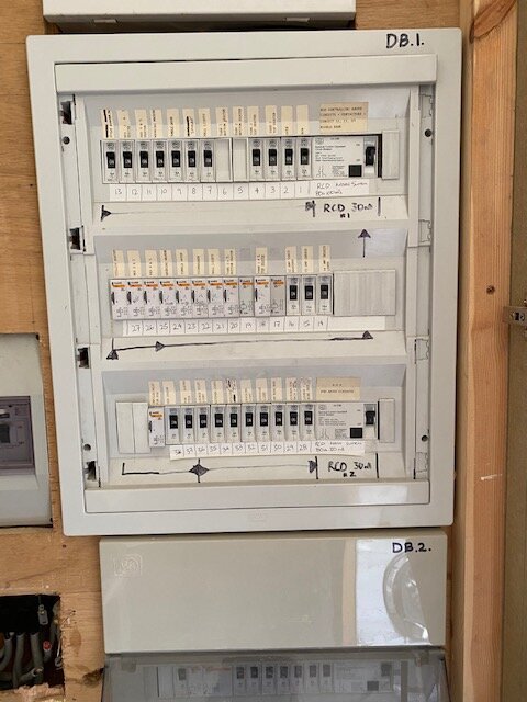

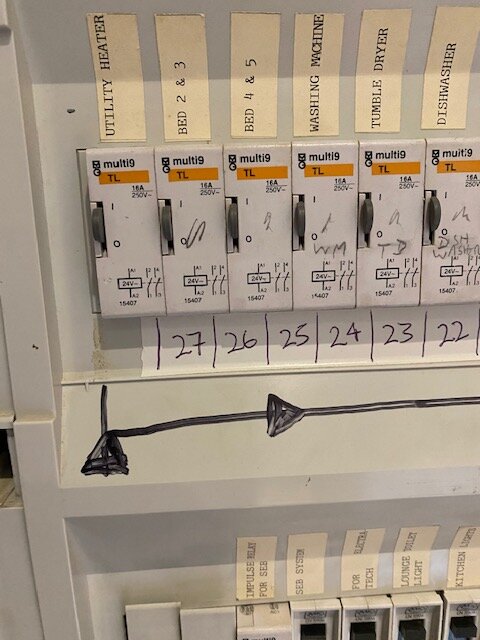

Hi, Last week I went to a property where the owners had just moved in. They wanted advice about various electrical things including a large DB filled with these multi9 TL contactors. Does anyone know what they are for and is it easy to remove them to change the board for a more conventional system?

Looks like the contactors are all controlling Radials, there is either local switched control for each of these or central control for all of them.
There may be a clue on the other DB section, more investigation required as to why it was done like this.

Just a guess but maybe their incoming supply was insufficient for the load so rather than have the DNO upgrade the supply they had load shedding contactors installed.
Being separate for each room, I expect there is a thermostat in each room that controls each contactor.
It is unusual to see that sort of thing domestically but I guess there is/was a good reason for it being done. The trick is to find out why it was done!
If you can take a look at the control wires for the contactors hopefully you can find out which of the above suggestions are in place:
  • Load control for DNO limit (or maybe backup generator limit?)
  • Off-peak usage
  • Early "smart" control from thermostats back to central point
As pointed out by @snowhead, there's a reference on one of the MCBs to ElectraTech controls having been fitted, so there would once have been a central panel for managing the heating and high-load appliances. There's also an MCB and relay labelled 'SEB System' presumably feeding the output of the central tariff control receiver into the ElectraTech.

Thanks for the replies. I have taken a few more photos. Does anyone know if it is straightforward to remove all of this and replace with a standard consumer unit?
Interestingly the house is all electric including storage rads, they have a 3 rate tariff and meter but the bill is less than £10 per month, faulty meter methinks.
The whole installation is protected by a 100mA RCD which trips when the rotary switch to the left of it is moved to 1 but I have no idea what that is for.

What's the reason for wanting to replace it?
It's quite likely that the customer is going to spend a lot of money and end up paying a far higher electricity bill unless you put some other form of control on all the heating which takes advantage of the 3 rate tariff.
If you check out the Electratech Professional manual I linked to earlier, it explains exactly what the Electratech system does.
We are just weighing up options at the moment but they would like the storage rads removed and something more controllable installed. So not definitely replacing it but just trying to find out more about it.
