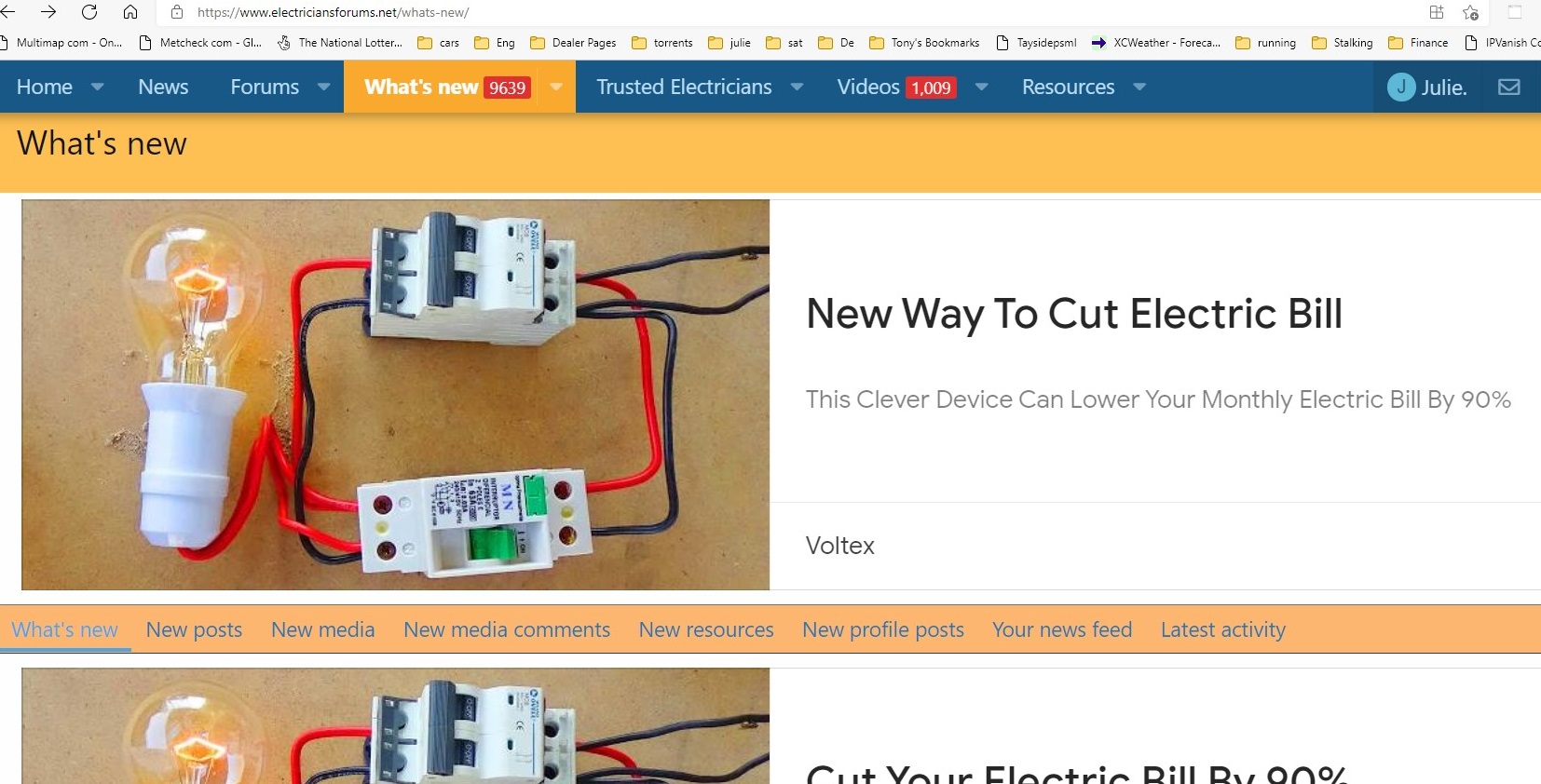

Since Electrician's forums are promoting this as a wiring example :
What code should it be given
C2 for exposed insulation
C3 for device not in its enclosure
C2 for no earth/CPC
C3 for wrong wiring colours
C2 for incorrect identification of line conductor
C3 for mixture of devices (if there was an enclosure)
C2 for no overcurrent protection
C3 for no RCD protection
need I go on?
Not being picky, but this is suppose to be a professional forum, that is advertising a scam product with just about the most appalling examples of wiring .
What do visitors think of this?

I think the forum is getting bigger and bigger which means more scam adverts will appear. Better policing is required, but the level of that policing depends on the morals of the owner and if they are more concerned with money or peoples safety.
It was just such adverts here that made me seek advice to get rid of them...and thanks to a forum member i no longer see them. However, the point you make is valid...no-one should see adverts for trash that is a scam, on a forum like this one.

When you click on the link on that particular advert….. that’s exactly what you get. A plug in power saver device that somehow smooths out the sin wave of AC and apparently reduces the wastage, thus reducing bills.
I’m sure Lucien or Marconi could punch a few holes in their technical reasoning.
Yes. @Dan, can you stop these stupid Voltex ads appearing? As mentioned above the 'product' itself is a scam and the ads show unrelated pictures of nonsensical and dangerous electrical practice.
I am bored with having three identical ads in Polish for the same Polish electrical course showing on the same page, but perhaps they are useful to someone. Voltex is useful to no-one and to have this misinformation displayed on an electrical forum is a kick in the teeth for those of us who try to provide safe, constructive and honest advice to visitors.
