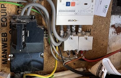

Doing an inspection and came across this.
Feeds are as follows:
Cutout to Meter - 25mm
Meter to connector blocks - 25mm
Connector blocks to CU’s (2 in the house) 16mm.
So far so good as the cutout is 80A not the 100A it’s labelled as.
My query is the 6mm 3 core XPLE that’s going to an outbuilding.
At the outbuilding end is 2 way CU with a 40 RCD switch and a 16a socket & 6a light circuit.
Now I know the RCD will stop the cable ever pulling more than 40A. But as it’s wired into those connectors it has the potential to pull 80a (in theory).
I’ve coded it as a C2 as to me it’s potentially dangerous given there’s no OCPD protecting the cable from the connector until it reaches the RCD in CU in the outbuilding. It’s been there approx 8yrs according to the owner and there are no signs of thermal issues anywhere at either end. But thought I’d garner opinion from the more experienced/knowledgeable folk on here.
What would you code it as? Or would you deem it safe given the RCD at the other end?

RCDs don't provide overcurrent protection. There is also exposed single insulation. There is no way this type of installation could be deemed safe. If there were sheathed tails feeding a switchfuse mounted by the meter fitted with suitable overcurrent protection for the distribution circuit, which then fed the (properly glanded SWA) that would be fine.
Gotta love it when someone asks about one issue, and the photograph they supply shows a number of others.
Apart from what was mentioned about an rcd not being an over current protection device….. how do you know that the fuse in the cutout is only 80A without pulling it?

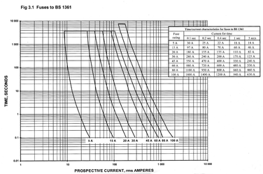

The downstream breakers at the outbuilding CU total 22A, so I do not believe overload of the 6mm cable is possible as it is. I think 433.3.1 would apply here, which would allow omission of overload protection if fault current protection is provided upstream.
So does the cable have fault protection? The regs say no, we're not supposed to rely on the DNO's device, so it needs coding.
However, the DNO's device is there, upstream of the 6mm cable, we can all see it. I would say if the cable met adiabatic requirements for the DNO's 100A fuse , then I would give it a C3. If it didn't meet adiabatic requirements, then C2.
@Raptor0014 , read 433 through to 436 in BS7671, and see what you make of it. I've attached fault curve for BS1361 fuses. As other members have pointed out, there seem to be gaps in your knowledge which really should be filled before you carry on with EICRs.

The 6mm cable is basically a sub main feeding the 2way CU in the out building, therefor a suitably sized s/fuse should be fitted at the supply end to protect the cable , at present its relying on the DNO fuse.
To add not terminated correctly/ no glands/ single insulation exposed / poor install to say the least.
