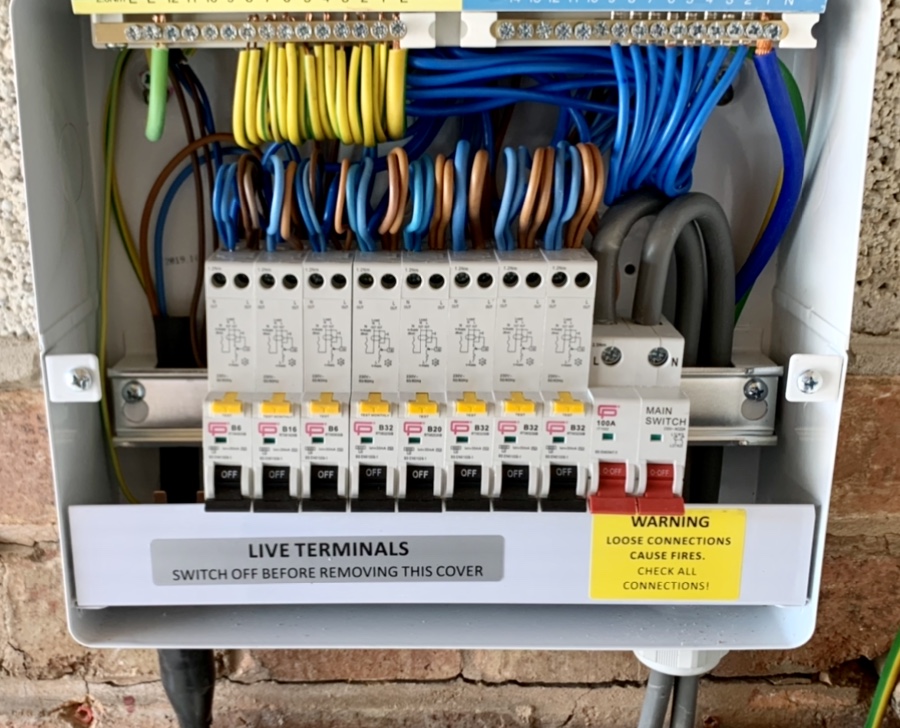

West Mids (coventry) large 2 bed bungalow complete rewire. effectively new build except chasing walls for 50% of accessories. RCBO board and gas bond, 35 down lights, utility room, kitchen with 2x cooker circuits (6mm each) lounge, 2x beds, bathroom with mirror and shaver point, en -suite, garage and loft lighting/sockets/ led battens and 4 o/s light in total 100points(sockets, switches, lights, fans,smokes,spurs etc) Supply all accessories (white decent quality) xpelair fans x3 aico heat/smoke, Ball park what would you have charged ? Recently back on tools finding my way with pricing. (Niceic Registered so all testing, certification and notification included of course )

If that pic is your work, then I think you have done this before.
Nice looking board.

Thanks. Yep it’s the board for this job. I did on a day rate of 200 for some builders I know. About 5 days 1st and 6 days 2nd fix (on my own) so far so 2200 labour and 1300 materials total. Thought about quoting per point but it was all too vague no kitchen or lighting plans etc it just evolved kind of.
