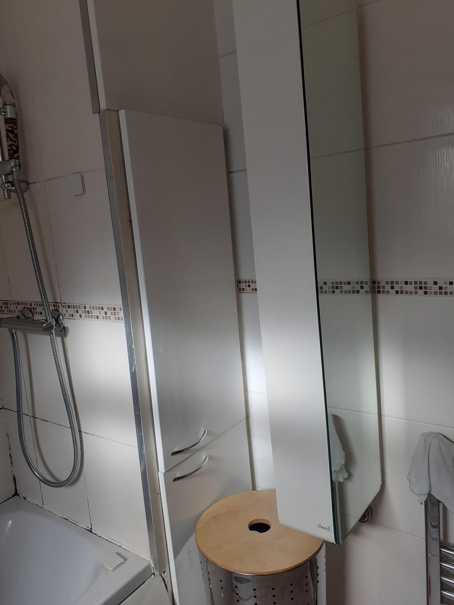

I have a situation where a megaflow system is installed in the Attic of a semi detached property.
The Immersion heater switch has been installed by someone in the airing cupboard which sites at the end of the bath tub ( and has been disconnected from the Consumer Unit).
It has been wired with 2.5 T&E up to the isolation switch and then from the switch it is connected via flex cable to the Immersion heater.
This means that the Switch is inside Zone 1 as the bathroom does not extend to 3 meters in length where the switch can be installed.
Where Can I re-allocate the Switch for the Immersion heater?
Can it be installed on the outside of the bathroom above the door besides the extractor fan Isolator switch?
Will I also need to re-route the cabling for the Immersion heater as it is in plastic conduit passing Zone 1 as attached on the picture?
The upstairs lighting is also routed via plastic conduit - will I need to remove all the wiring from this location and reroute it from outside Zone 2 or the bathroom altogether?

It’s only sockets that follow the 3 meter rule from a bath, if its in a cupboard i doubt its in zone 1. To answer your question the new switch should be near the immersion , if that’s not possible it should be marked as immersion isolator .
Zone 1 is the area directly above the bath, and zone 2 only extends to 600mm from the edges of that, so the switch in the airing cupboard is almost certainly acceptable as far as zones are concerned.
There should be a switch adjacent to the cylinder for isolation purposes when working on it, but this doesn't have to be the only switch controlling it. A switch in a more accessible position can be used to switch the heater on an off, and the one in the airing cupboard can be retained for this, although probably not the most convenient position.
If it were me I would put the new switch in the loft somewhere near to the megaflow

Thanks for the update on this subject. Upon measuring this it seems like the switch is less than 600mm from the wall see picture attached - its actually 470mm from the end of the bath tub.
I can factor in adding an isolation switch for servicing purposes.
Are you sure the switch can be retained in the airing cupboard. If I were to move the switch where could I move it to? outside the bathroom above the door?
The switch has a label on it Water Heater as shown.
The flex run is 5 meters from the load side to the immersion mega flow system.
Would it also be possible to comment on the other cables passing through the airing cupboard as well. The lighting feed for the upstairs lights pass through the airing cupboard but this is enclosed in conduit as shown on the picture

That's is, nt how the 600mm for zone 2 is designed to be measured. It, s not how the crow flies. It does, nt go around doors or through walls. Its 600 mm in an outwards unobstructed direction from the edges of Bath or shower.
Secondly, bearing in mind that the perceived danger to switches in the bathroom is from condensation resulting from moist air, I don, t see that arising in the hot press. For those reasons I would leave it where it is.
