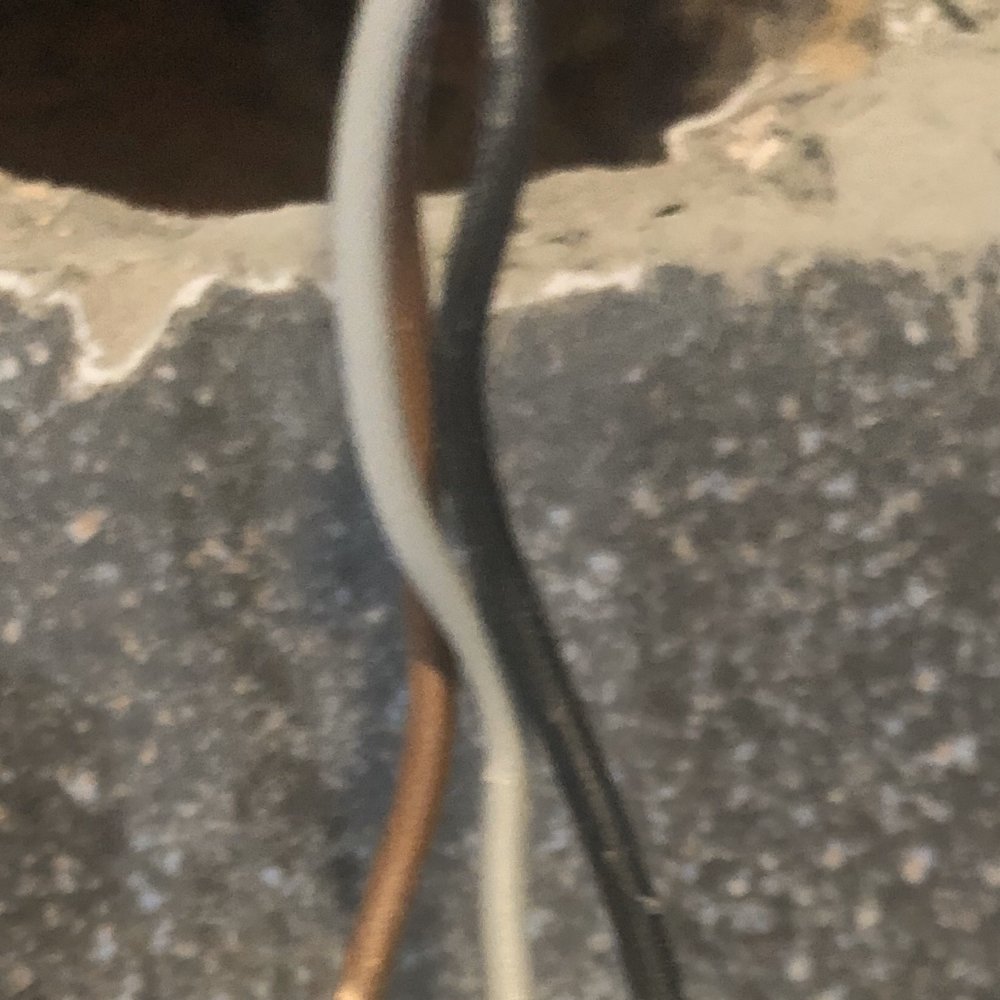

I am Uk based: I have brown, blue and black wire on the extractor fan. From the power source I have brown, grey and black wires... please how I connect them to the extractor. All help be great.. thank you

The painter took the fan off and all I want is to connect back up...but I am not sure how the wiring goes.. please advise
Is this replacing a fan that was already connected?
No same fan ... the painter took it off and I do not know the wiring combination

Sadly there are no set rules for this. Most likely your fan has brown = live, blue = neutral (harmonised = current British colour code) and by elimination black is probably the switched live (i.e. from the light).
At a guess the cable would be brown = live (because that is the harmonised colour for live), black = neutral (because that was the old British colour for neutral) and so probably grey = switched.
But you really need to check carefully as the person who wired it might think differently from me! If in doubt get a sparky in to check, don't try to test a live system yourself.

more likely brown L to brown. Black switched L to Black , Grey(should have a blue sleeve) N to Blue. if the brown and black are reversed, the fan won't operate so switch them round. failing which, get a local sparks to ID the cores and reconnect.
You would need to test/visually verify the other end of the cable. As it is still common to see people using a black wire in a harmonised coloured cable as neutral, even though they shouldn't.

Traditionally core numbers 1 and 2 were used for lives and core number 3 was always used for neutral in this kind of arrangement.
1 being brown (red)
2 being black (yellow)
3 being grey (blue)
So the blue was always used as neutral therefore the logical choice is grey for neutral.
