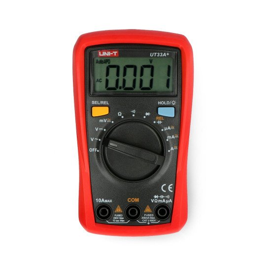

I’m afraid the only way to be sure is by testing with a voltage tester. Either two-prong or non contact.
I won’t go into how you do that until you can say if you’ve got one and know how to use it.

I have a meter like this:

These earths need proved that they do actually go back to the fuse board.
It’s been a diy job when first put in, using whatever cable was available to be scrounged at the time.
So we can’t advise without testing. Only guess, which wouldn’t be smart.
