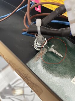

I am replacing my ceiling rose with a metal 4 spot light bar, the cables are to short to be able to secure them unless I release the block from the light it’s self.
I can then wire it with ease but can’t get the block back into the fixed earth nut.
Would it be ok to replace this nut with a piece of earth cable / earth cable and loop? There are 3 earths going into it from the ceiling.

In my view you would be best advised against replacing it with a loop of wire. The wire could easily pop out from under there, be crushed to the point of failure and then the case will have no earth. The correct course of action is to extend the conductors coming from the ceiling.
Possibly with some nice maintenance free connectors such as Wagos, being sure the earth is properly sleeved. That would allow you to properly terminate both ends and then mount the lamp on it's base.

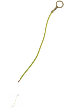

Appreciate your advise, I was thinking of something like the below? Not physically looping the wire.

So this is where my view may differ from other peoples.
The light is supplied as an assembly. That assembly was designed (I appreciate some lights are just thrown together) and theoretically it was approved/tested to certain standard, one of them being the quality of the earth connection... perhaps the most important connection of the whole assembly.
Let's say you replaced the earth connection with that and something happened, a fire started and the seat of the fire was found to be the light. It could be argued that the manufacturer holds some liability if it was found that there product was poorly designed/manufactured. But that would only hold true providing it was as assembled, which it would no longer be because you would have modified it.
You would have effectively taken on the role of designer and along with it the responsibility for ensuring it was safe.
With my super cynical view out of the way, the other side of this is that you're not going to be able to put something like that into place without cutting the cables that run through that hollow bar, so there you'll be introducing more connections... more connections = more possible points of failure.
Seriously, the simplest solution is to extend the cables that are too short.

Yes I realise now you’ve pointed out, that I can’t get the nut off without cutting other wires! I initially thought I could just screw it off.
So the best option will be to extend all 3 of the earths coming from the ceiling into individual wago connectors? With either side of the connector sleeved?

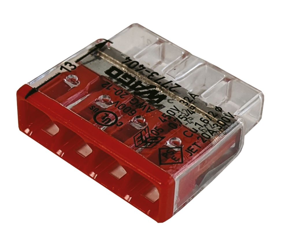

For most lighting applications, if you're not using them on the regular a box of 4 way push fit connectors will provide the maximum number of termination points you'll need (typically there are 3 cables... loop in, loop out and switch and the most conductors in a single connector will be 4... the earth... the others only need 2 and 3 ways but if you're not using them regularly, buying all the different ones is a costly exercise).
https://www.screwflix..com/p/wago-2773-series-32a-4-way-push-wire-connector-80-pack/578pf
You'll typically need to cut off the existing exposed copper due to damage by the screws and then you need about 8-9mm stripped and just push the conductor home into one of the slots of the connector. If you make a mistake, you can extract the solid conductors by pulling the cable out of the connector whilst twisting the conductor in the connector.

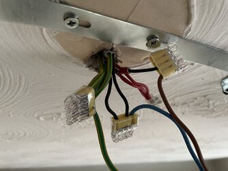

The picture below is the correct connections, just for clarity.
So I can run the 3 earths into a wago, then 1 new to the fitting. The 2 neutral with 1 new then to the fitting.
I will leave the switched live and the ring main as it is.
Would it be ok to replace an earth nut on a ceiling light with a cable / cable and loop? D9E51DB4-D362-44A7-8DD0-57E1F23D87D0 - EletriciansForums.net
Take care that the single black with red sleeving doesn’t get mixed up with other blacks. Single is the switched live, other two is neutral.
Also isolate the circuit… as all those reds are permanently live.

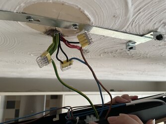

Would it be ok to replace an earth nut on a ceiling light with a cable / cable and loop? E88FA553-98E0-4333-9DAB-915BDDD9D9D4 - EletriciansForums.netWould it be ok to replace an earth nut on a ceiling light with a cable / cable and loop? E88FA553-98E0-4333-9DAB-915BDDD9D9D4 - EletriciansForums.netI used to only use 1.5mm cable for lighting, but I've seen the light and now a days I only use 1.0mm. For Wagos, it really needs to be a solid core. You can get 7 strand cable into them but it is a bit of a pain.
Thank you Sparky for all of your help!
