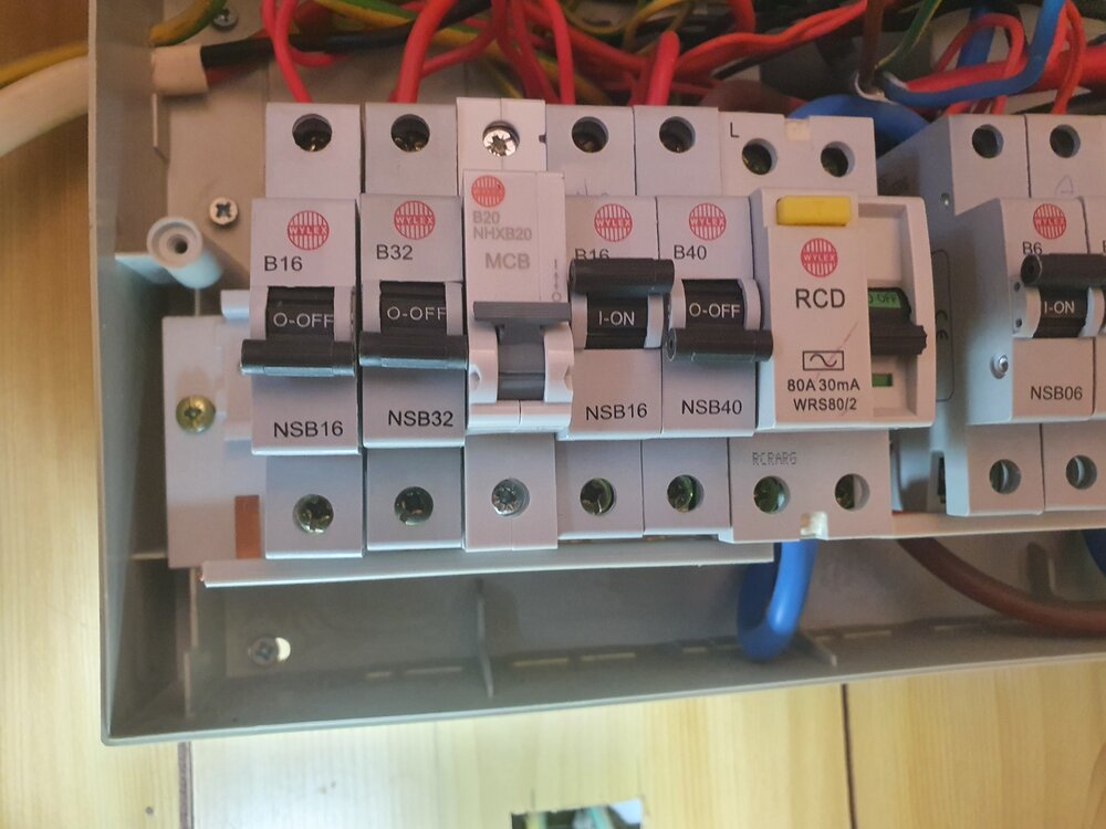

A client has a Wylex NHRS RCD main switch CU with MCBs prefixed NSB. I don’t use or see a lot of Wylex kit; are the newer NHXL prefixed MCBs compatible with this ’board?

Thanks for replying, but I’m a little confused:No you need NHX which you can still get.
That clears it up nicely. Thanks happysteve!!!If they're "NHX" MCBs then yes, they're compatible with both types of bus bar (balcony and cage). Same applies to the old (tall) "NHXS" RCBOs
The newer "NHXL" MCBs only fit with the cage style bus bars - same applies to the newer reduced height "NHS1" RCBOs.
Essentially, the newer MCBs and the mini-RCBOs don't have the slot near the cage screw to go on to the "balcony" bus bar - but the cage connections line up fine, and you can mix and match.
Nearly came to that with the front - the new MCB doesn't line up with the hole so the plastic is nicely bulging getting the lid screwed on tight - It will have to do until I can find a better solution.old adage... if you can't fit it with a hammer, it don't fit.
I have a Wylex NSB20 kicking about if you need one.Nearly came to that with the front - the new MCB doesn't line up with the hole so the plastic is nicely bulging getting the lid screwed on tight - It will have to do until I can find a better solution.

Hmm. TLC are claiming that the NHXB20 are a direct replacement for NSB, but in their picture the switch is black, while the one I got from Toolstation has a dark grey switch (even though their website picture is black)
Have they changed production recently or something? Or was there more than one generation of NSB??

Buckfast is kindly sorting me out - but seems like Wylex are added to the list of changing compatibility.I have a Wylex NSB20 kicking about if you need one.
