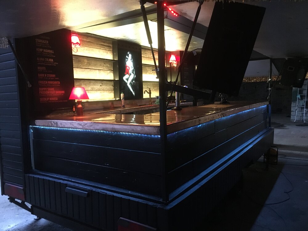

My mates bought a mobile bar. I’m going to be checking the electrics but I’ve got a more plumbing question.
he’s wanting a small under sink water heater, just for hand washing. There’s little chance he will get a fresh water piped supply where he sets this thing up. His idea is to get a water barrel like one for a touring caravan, but use a 230v pump instead of 12v (there is no 12v system installed)
Would any shower pump work?
Needs to pump water from the barrel for cold water, and through the heater for hot.
the electric supply is limited to the 16A commando plug, so a max 2kW water heater? When there’s 2 bottle fridges, a freezer for ice cube bags and whatever lighting he plugs in.
The other question. More a statement of fact, I’m pretty sure what the answer is going to be....
There is no consumer unit in this shed on wheels...
There are MCBs and an rcd mainswitch mounted on dinrail, inside plastic 100x 50mm trunking with the lid cut to suit.
Is this, or has it ever been, acceptable.?

This unit seems to have been hand built, 3 sides open up, metal supports each corner. As described in the OP, any consumer unit is non-existent. Belfast sinks used as ice buckets, and the worktops appear to be copper clad. A few old immersion tanks were harmed in the making of it.

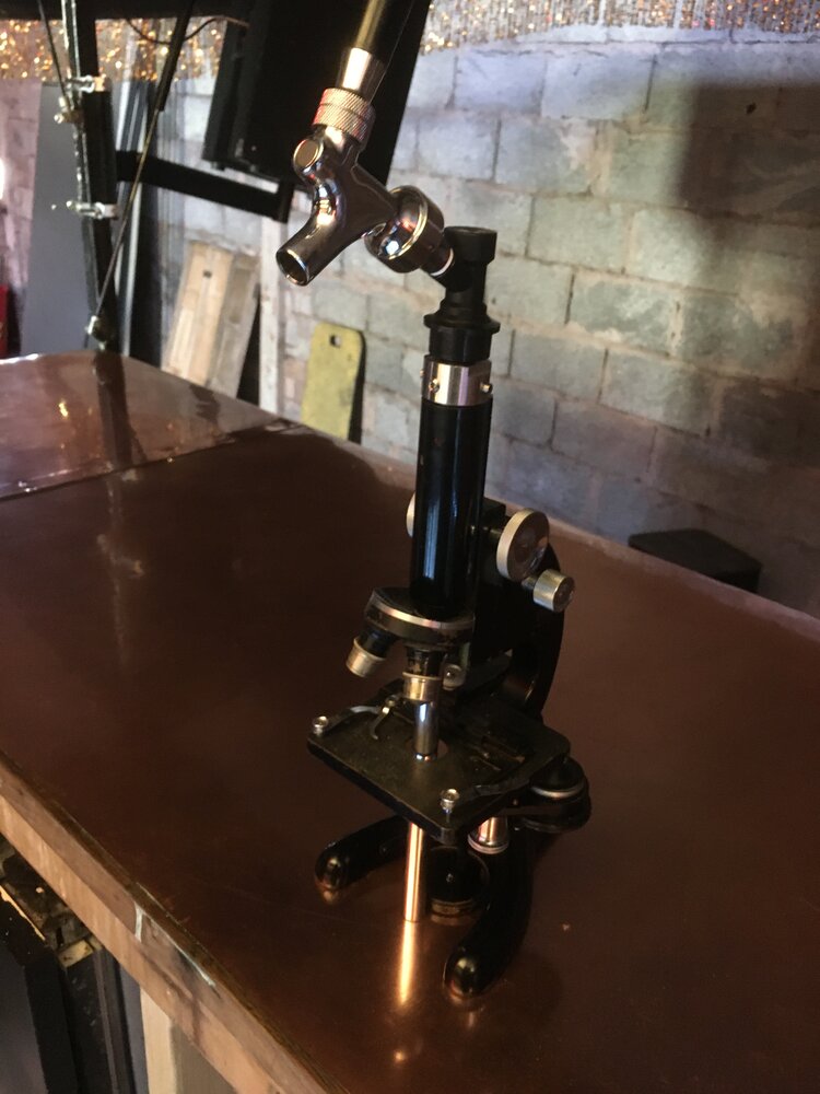

That is a microscope.... repurposed as a draught gin delivery system.
