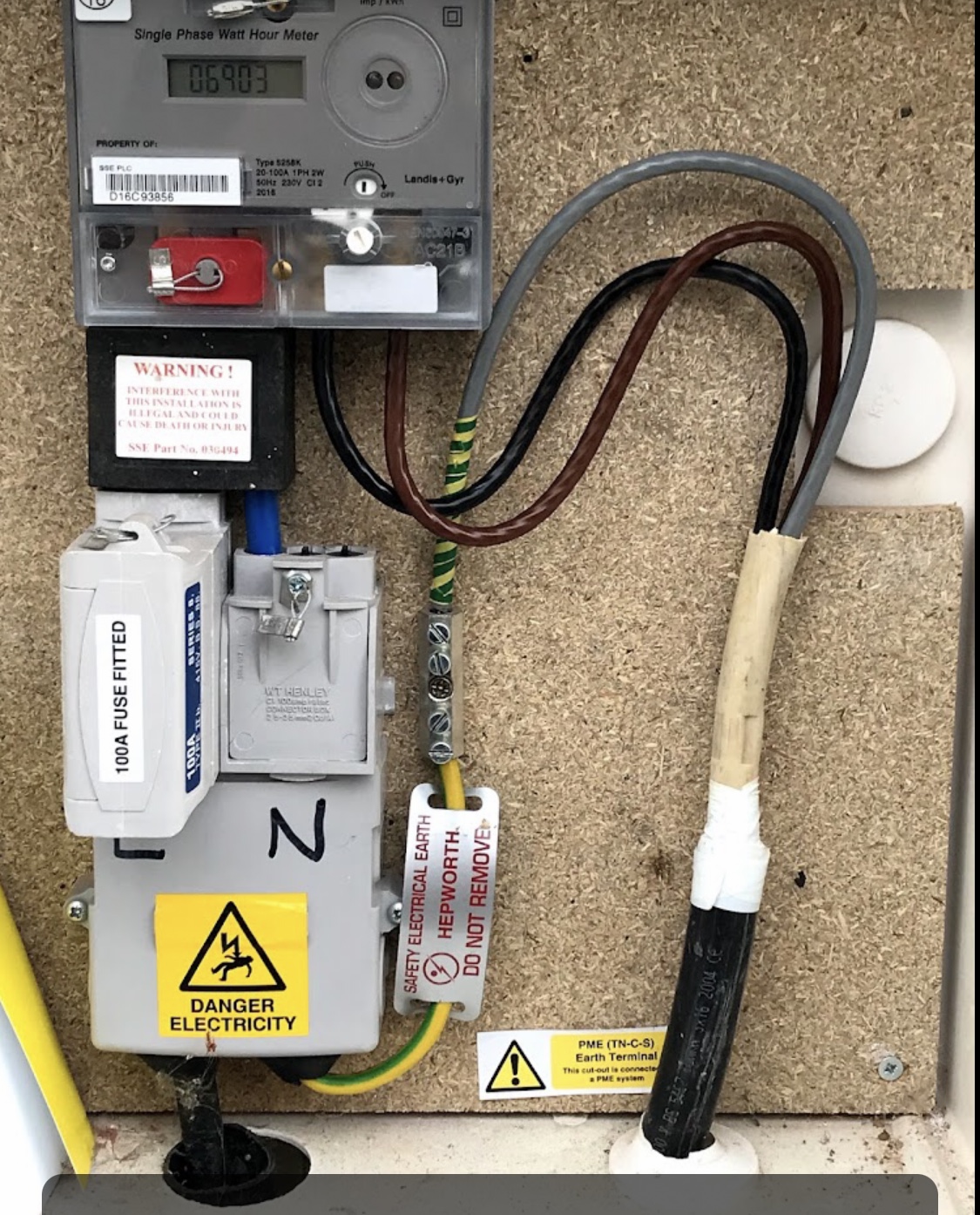

Things wrong in this picture;
1. Basic insulation showing (meter cabs are not considered suitable enclosures) interestingly site applied insulation (heat shrink) is no longer classed as suitable in an application like this either.
2. Black being used as the N (personally don’t see a problem with it and I’m not aware of any regs which explicitly state black cannot be used as a neutral) but the NICEIC ran a campaign to “de-neutralise” the black. Bigger problem IMO is no sleeving to identify it as a neutral.
3. Difficult to tell from just a photo but that doesn’t appear to be a 25mm SWA and the cut-out says 100A fuse fitted. So OCPD is too large for cable.
4. Whilst not a 7671 reg most DNOs/DSOs specify that meter tails can only use the cutout fuse as an OCPD where the tails are less than 3 metres.
5. SWA braid is not earthed.
6. SWA is not terminated correctly.
Or not as the case might be.
Think there was a debate previously on the forum as to whether a meter box is considered an enclosure because it is lockable (don't laugh) and a key is needed!
According to NICEIC and Select it isn’t classed as a suitable enclosure as non-skilled persons access the enclosure regularly/to read the meter etc.
Glanding the cable to a metal fused-switch like the Wylex ones would have been far better, then double insulated tails to the meter.

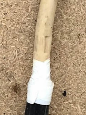

It looks like the "filler" insulation around the 3 cores has been clamped or similar - wonder how that dent happened?
It looks like the "filler" insulation around the 3 cores has been clamped or similar - wonder how that dent happened?View attachment 112405
Didn’t even see that dent/damage.
Looking at the size of the damage, it could have possibly been some sought of over tightened Earth strap? (But why)? I’ve run out of idea.
