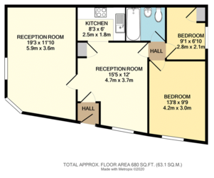

I've recently has an EICR (report attached) carried out on my two bed flat because I need to rent it out for a year. The electrician has come back saying I need to replace the fuse box to pass the inspection (which I was expecting as no RCD and generally out of date), he has also 'strongly recommended' a full rewire of the flat because of very low insulation readings. The cost of the fusebox and other C2 item is £640 or for the full rewire they have quoted £5400. The wiring is 40 years old.
I've not got the money to be able to do the full rewire at the moment and would need to save up a bit to be able to pay for it. But if I can't rent the flat out then I won't be able to do that. Ideally I would replace the fuse box now and then do the rewire within the next year or two, but I don't want to put potential tenants in danger (They did not say that a full rewire was required to pass the EICR).
My questions are:
  • Is it possible to replace the fuse box without doing the rewire immediately, or might this cause new issues to arise? i.e. frequent tripping
  • Are the resistance values as bad as they are saying, and is there a real safety hazard there?
  • I'm getting a couple more quotes for full rewire but does 5400 sound fair for a 63 square meter flat (floorplan attached)

£5.5k sounds a bit steep for 3 circuits. Agree with general points above regards due diligence. Effectively you do have RCD protection which seems to have been omitted and not tested. Forty years usually has loads of dirt and fauna in the fittings which may in part account for low readings. The insulation reading do technically meet regulation but it is recommended that 2Mohm at least is the desired level of insulation resistance. so a couple of them are below that level. It suggests the further investigation may be sage to find out why they are so low. I have rewired much much worse than this and the cables have been fine. However there were extremely damp walls and no back boxes on the sockets they were just screwed to the wall and the wall hollowed out a bit to accommodate the socket.
A new box would be a good place to start. Yes tripping may occur. However a bit of investigation should obviate that. I think you could get a better quote. I would be looking at 3-4k for that rewire personally. It might be sage to investigate low IR readings first which I think any decent spark would and remedy that prior to box change to ensure no tripping. Having said that you do have an RCD which is not tripping. I picture of the supply to that RCD would be good. And finally is it an upstairs or downstairs flat?

The flat is a ground floor flat that has had some problems with damp, could this be the potential root of the issues?
I think it is more that the report is a draft, i.e. not complete. Wouldn't want you to tell the sparks that no serial number means it's invalid as they won't wear that. Being a ground floor flat means that upstairs will have to have floor boards up. Is that viable? £640 for a box change is not too bad. Think I would charge more potentially but I like to use good kit which is more expensive. And of course there is the investigative work. Can you get to the flat above?
