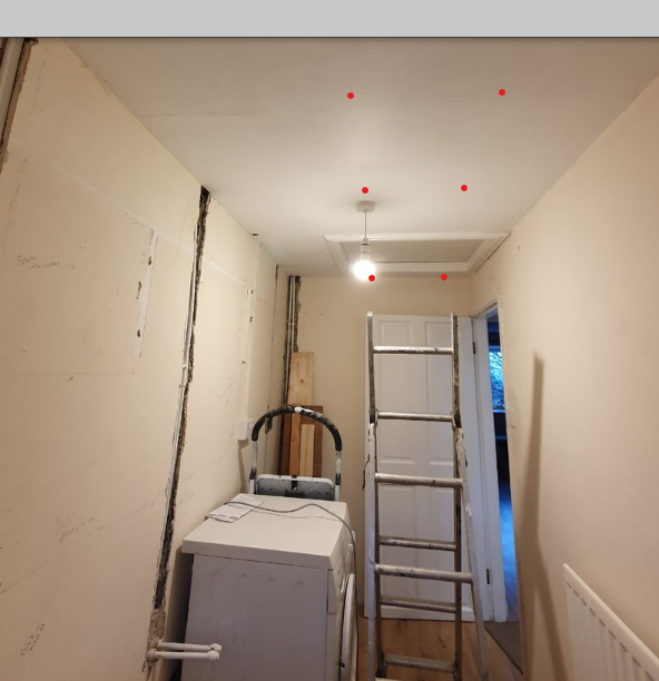

Hi all,
Getting the utility room redone at this project house and the misses is absolutely adamant she wants downlights. Couple of reasons for this, firstly better light spread across the room since its long and narrow, secondly ceiling is very low (only around 2m) so I actually hit the existing pendant and I'm 5'9. Doesn't fancy a batten type fitting, which is fair enough since they do look quite commercial.
However with the loft hatch being where it is, even putting a 60⁰ beam angle downlight right next to it would leave the area by the door a bit dark and shadowy, which is the problem we were trying to solve.
So I am wondering what peoples thoughts would be on putting a downlight actually in the loft door?
It would have to be on a separate flexible cable run towards the hinge end but in theory it might be ok and it's not like the door is being used everyday? Unusual setup sure but in theory is anything wrong with it from an electrical perspective, obviously cosmetically would just have to be tested and might look too weird.
Thoughts appreciated, or any other suggestions but she is quite set on downlights or at least some kind of lights that are flush to the ceiling.
Thanks!
I wouldn't put one in the loft hatch. What about wall mounted lights in conjunction with ceiling down lights?
Fair enough I did think it might be a bit of a long shot. That's a good shout actually thanks, could probably find something suitable which would have to go above the door, maybe still a bit unusual but 2m of headspace isn't much to play with! And there are slim wall units going on the wall with all the chasing so no lights can go there, they will have undercabinet lights but doubt they'll work for main room lighting.

But more seriously, there is room for a couple the small side of the hatch which could be adjustable downlights angled away from the wall, so I could imagine something like this working:

What is the dimensions of the room? Looks to me about 2.5 x 1.5 metre??

The room is 1.3 x 3m. The pictures were taken with the 0.5x lens so it put things rather out of proportion, the small gap on the side of the loft hatch is much smaller in real life however would just about fit a downlight, unsure whether it would technically be far enough away from joists, but probably not that serious for LEDs (was planning on using collingwood H2 lites). However I didn't even think of using adjustable downlights so I might buy one and test it on both sides of the hatch, to be fair it might actually be enough just putting it next to the loft hatch on the long side of the ceiling.
I'll forget the idea of putting one in the hatch seems like there's better ideas!
1.3m wide doesn't give much room for spacing out 2 rows.

Indeed, was thinking one row in the middle (or as close as possible with joists) between the wall with the door and the wall units which will butt up to the ceiling. Picture of the design is attached, and yes there will be under cabinet lighting which will help but not enough for main room lighting. Agreed a batten would be practically good but to be honest neither of us like the look of them on a house ceiling.

That loft thatch looks massive from one photo and tiny from the other way like 2 different rooms.
I'd put 4 in, 2 close-ish to the loft hatch and 2 half way from them to the window. Put bright ones in and when she moans about it being too bright show her the dimmer switch. Then she can be right about how bright it should be and wont get to complaining about the placement.

Yeah the photos are in 0.5x zoom to try to get the whole room in so are a bit misleading. The hatch is actually unusually big though as a hot water cylinder needs to be able to fit through it, can't remember the exact dimension but don't think it's far off a meter square.
I don't think I can put 4 like you suggest as the width is so narrow especially once the top cabinets are taken into account, so would have to be all be in a row. As for the brightness could use GU10 fittings of course but have used a lot of and grown to rather like the collingwood H2 lites they've got a nice spacious terminal box and good light output. I'm sure she won't complain 😬
Looking at those drawings, there's not much scope to obtain good lighting from downlights.

With having lights under the units, id say you only need 3 downlights equidistant in the ceiling.... but one would be right where the hatch is.
Can the hatch be made smaller, or moved to between light positions?

The hatch definitely can't be smaller as it needs to be big enough to fit a hot water cylinder through it when it inevitably needs replacing one day. As for moving it, its physically doable but it's currently in a position with maximum headspace above which is still only maybe 4-5ft so wouldn't really want any less. Basically I think we just need to work around it.
So thanks to advice here what we're thinking is 3 downlights, first one a tiltable one right next to the long side of the loft hatch and then 2 other standard ones. Putting one next to the wall isn't really possible, I've checked the joists above and there just isn't enough clearance. We may also put a small wall light above the door if that end is too dark.
