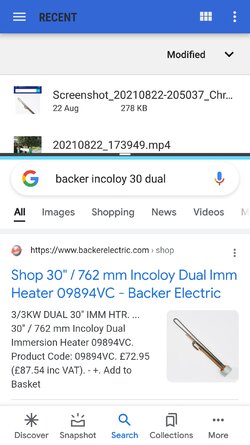

I've also just found that Backer make a dual immersion dual thermostat unit 30" and 16" elements at 3kw each with thermostats controlling each element.
I'll either fit a new single long element or that Backer dual unit. My initial tests using only the 36" element on partially sunny days are leading me back to the dual immersion idea. It partially heats (35 degree) a lot of water which is just a bit too cool for a shower but I could have a very long, cooler shower, rather than fully heating (65 degrees) approx 15 litres of water .....note all those values are very approx.
