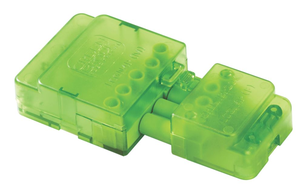

These are cheap and for lighting (4 pole so PL/SL for emergency lights as well), but maybe an issue of cable types they would clamp:
https://www.NoLinkingToThis/p/greenbrook-20a-4-way-connector/176gv

I like the powercon connectors that Rockingit linked, will be having a look at those. Think the Greenbrook connectors might be an issue with the HO7RNF cable i had in mind for the drops down from the ceiling (and they look a bit flimsy/domestic).

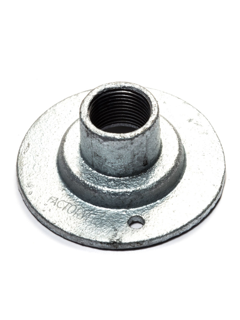

Many diffrent ways but one that springs to mind is M20 galv thru boxes woth dome plates to M20 stuffer? Or adaptable boxes with CPC links
