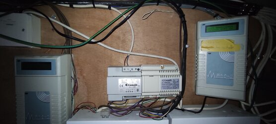

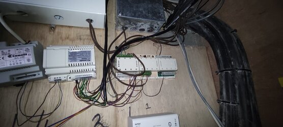

One today I was looking at in SE London, built less than 20 years ago - and in the communal meter cupboard (locked but with a standard fire door key which every flat has to read their meter)...I find this mess...
Might have found why their intercom doesn't work!
And yes that is 2 feeds at 230V at the top of the transformers...

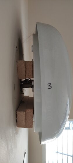

And one of their emergency bulkheads fitted like this in the main stairwell
