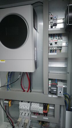

Hello All
Can I say to start with I am not an electrician but used to be a heating engineer (yes I can hear the groans). I have wired the installation myself using the correct wiring and isolators, racking and trunking and it is not grid tied it is purely off grid with a separate input for a backup supply from a generator or the grid. The system does not feed back to the grid and when the mains is disconnected the system isolates the ac input internally in the cabinet with relays
In my solar setup I have a purpose built cabinet containing all protective devices, with isolators and an Axpert MKS V4 5.5kw inverter. The kit is housed in a fireproof cupboard outside the house. The unit is supposed to be a plug and play with 2 x us5000 pylontech batteries beneath the cabinet connected in parallel into the main input on the cabinet as well as AC input and AC outputs on the side of the cabinet. The PV goes into the cabinet and then into the appropriate connections fitted to the cabinet I have separate isolators external to the cabinet for both PV and AC and the supply for the AC backup in, runs off of a 32 amp line from the consumer unit.
The issue at present is that the main breaker in the house trips when the inverter switches over to utility to charge the batteries over night. The 32 amp m.c.b does not trip but the main isolator to the board does, I think it is an RDC isolator main switch ( I have attached a pic) The cabinet has a soft start relay for a generator but as the supply is from the mains the relay becomes active as soon as an AC supply is applied to the inlet socket.
Is there a device I could add to the line in before the solar cabinet and on the supply from the consumer unit in my house that would stop what seems to be a surge when the inverter calls for AC power.
My setup is that I have a separate solar supply to my house hold appliances via a new consumer unit next to the cabinet and then separate cabling to all outlets in the house.
I am trying to have a system where I power all of my regularly used stuff from the batteries and solar panels in the day and then just use the AC into the house as a way to supplement additional power to keep the batteries fully charged with cheap rate overnight electricity. At this time of year the solar gain will be fairly low, I am in the U.K.
Any suggestions would be welcome. I am new to solar and am finding my way albeit slowly.
Regards and thanks Tonyboy
A couple of possible causes:
  • You have some sort of N-E fault in your installation and it is only on-inverter that enough difference is present to cause enough current imbalance (N not matching L) to trip things.
  • You have something else fundamentally wrong with the inverter or its wiring (N not earthed when running, or L & N swapped wihch is very bad)
  • It is simply the act of bringing the supply on quickly that trips the RCD. This is quite likely if it is a 30mA device for the whole installation. If you switch the mains AC on and off via the isolator switch (RCD on and ready to go, not enabling inverter at all) does it also trip? If so its down to the arrangement you have.

What does the inverter manufacturer say about supply RCD protection?
You would be well advised to clamp the tails supplying the board that trips with an ammeter that can resolve mA to see what leakage is present before and after the inverter is running. If it is above 10mA then tripping is quite likely (as "30mA" are specified to trip below 30mA but above 15mA)
This bit:
Funnily enough though when the pv arrays were earthed to the ground rod the inverter never tripped the house at all. The only issue was when the earth was connected, the pv voltage measured at the connection to the cabinet went from 250v dc to380v dc and it was sufficiently close to the max pv input of 500 v to make me remove the earth cable
Really does not look good! For a start, if you have an independent supply you must have an independent means of earthing! You cannot rely on the DNO still being connected during any outage. Also is it not the inverter that gets earthed, and the array of PV pannels is floating so it can check the insulation resistance? (at least a friend who has an ABB inverter works that way) Again, what does the manufacturer say?
Also 380V is nowhere near a 500V limit! I would expect an over-voltage error from the inverter if it were the case.

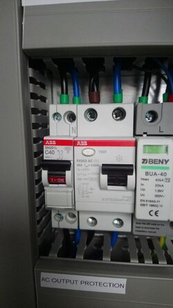

Please tell me the part number of the output 40A ABB RCD or post a closer picture of its front - I want to see if it is single of double pole.
Hello Marconi
Thanks for the guide and for taking the time to help me.
Just as a double check the reading on the meter with the 2 probes together was 00.1 and 00.2
The earth on the plug to incoming N, I had no reading
The N on the incoming C40 mcb to N on the outgoing RCD no reading.
I have also attached a pic of the output Rcd as requested.

Just to be sure - nothing you have done wrong - but would you measure the resistance between the two blue N connections at the bottom of the inverter box - see attached image and area circled in blue. If there are ac isolator switches on the the inverter box then please turn these on. As before all other power disconnected and isolated.
I am trying to establish whether the incoming N is permanently connected to the output N. (It may actually be a switched connection but at the moment I don't want to work on the cabinet when powered up.)
This link has a picture shwoing the internally linking of in N and out N:
Connection of Inverter Energy Systems to the Grid: New requirements surround residual current devices - GSES - https://www.gses.com.au/battery-storage-systems-what-are-their-chemical-hazards/
The tack I am following is that you have been sold a cabinet designed safely to take mains power from a generator which has an isolated neutral ie: not connected to earth E. When this generator is replaced by the UK mains supply the incoming mains N is connected to earth as the norm. Alas, your cabinet has an output N to E link as well which is troublesome when the inverter is in bypass/line mode ie mains supplying the output not the inverter. The effect of presenting your home's main RCD with an NE link before it and also after it is that not all the neutral current passes through it - some takes a different route via the two NE links. The net result is that the home RCD detects rightly a difference between the L and N and trips.
What some systems do is switch the output NE link in and out of circuit depending (respectively) on whether it is the inverter or mains supplying the output. At the same time the output has both L and N double pole switching between inverter LN and mains LN - at no time is the output connected to both Ns - that from the mains and that from the inverter. (Of course the switching also prevents both Ls from the mains and the inverter being connected to the output at the same time).
eg: Automatic Neutral-to-Ground Connection - https://www.sigineer.com/news/automatic-neutral-ground-connection/
Note that this is a US reference but it gives you the idea of what I describe.
What's important for safety is that for loads connected to the inverter cabinet output the N is always referred to E irrespective of whether the source of electrical power is the mains, a gennie or the inverter in order that fuses, mcbs, rcds, rcbos will operate in the event of an earth fault or earth leakage whether that be L to E or N to E.
AS this is a bought product, can you send me details of what you bought and from where and I while seek some technical clarification from the supplier/maker on what was intended in way of mains input.
Please do not change anything yet.
The tack I am following is that you have been sold a cabinet designed safely to take mains power from a generator which has an isolated neutral. When this generator is replaced by the UK mains supply the incoming mains N is connected to earth as the norm. Alas, your cabinet has an output N to E link as well which is troublesome when the inverter is in bypass/line mode ie mains supplying the output not the inverter. The effect of presenting your home's main RCD with an NE link before it and also after it is that not all the neutral current passes through it - some takes a different route via the two NE links. The net result is that the home RCD detects rightly a difference between the L and N and trips.
AS this is a bought product, can you send me details of what you bought and from where and I while seek some technical details from the supplier/maker and what was intended in way of mains input.
Hello Marconi
I measured between the two Neutrals at the input and output on the inverter and got no result at all.
The cabinet we bought is an SP5048 silent power plug and play 5kw that has an axpert MKS 4 inverter (5.6 kw) and not the voltacon V7 (yellow 5 kw inverter) that is in the product description. I am assuming that the actual cabinet layout and controls are the same for both model of inverter but I am by no means sure.
The company are Voltacon UK Ltd in Coventry
I believe I mentioned previously that the inverter has a fault F12 which is a dc/dc overcurrent issue that I have still to rectify possible by returning it to the supplier. Someone on another forum seemed to think that this is an MPPT issue.
I am hoping that this fault albeit on the P.V. side of things is not having any effect on the AC side of things.
I would be interested to see how forthcoming they are to you and that they can provide some sort of specific answer.
I will not be able to get back to you now until the weekend as my work commitments mean I am out of the house.
Many thanks for the help
Regards
Tonyboy
