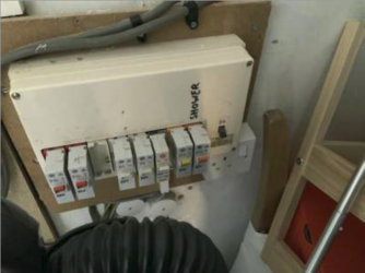

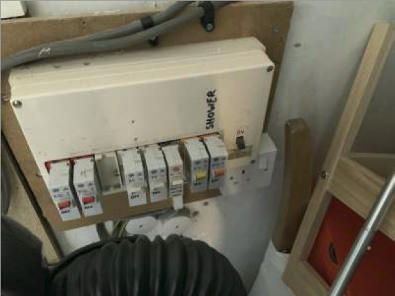

Here's a picture of the current board - thanks again for all your input

I've looked through the report. The last page is a helpful summary. If it's still accurate I'd say you need as a minimum:
Supply earthing checking (though codings don't completely make sense for earthing type stated)
Gas bonding adding (this shouldn't usually be too hard)
Upstairs light and downstairs socket discontinuous earth conductors need checking and sorting
The lights mentioned need looking at regarding necessity of fire rating
New consumer unit
(The single socket under the consumer unit will be an easy fix)
It should be noted that the upstairs lights and the downstairs sockets were not able to have any meaningful test performed on them due to the broken earths, so the insulation resistance tests which confirm the wiring is in good condition couldn't be carried out.
There is possible evidence further alterations have taken place since that report, such as spare circuit 1 now saying "Shower" on the consumer unit.
Personally, I would not exchange until:
1) You have an answer about whether any remedial works were carried out, with receipts if they claim any have been performed.
2) If no remedials, you arrange for a new EICR by an electrician of your choosing and an appropriate discount is mutually negotiated to cover remedial work. OR
3) You ask for a discount to cover part/full cost of a new consumer unit being installed. (easier)
All the best with this.

Yes, the EICR has no mention of a shower, but the photo of the CU shows one is now fitted!
Yes, that's something they have invested in, and part of the concern. You would have thought a new consumer board at a minimum would have been on the list, but the vendors haven't viewed that as a necessary investment.
