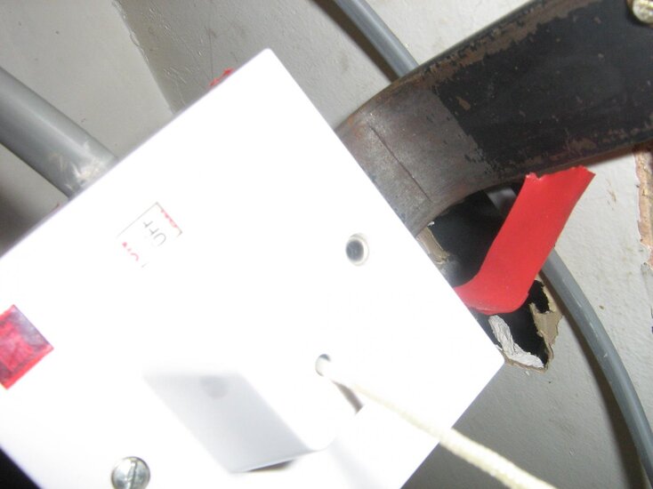

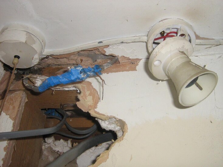

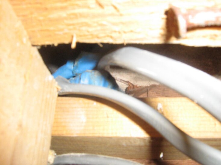

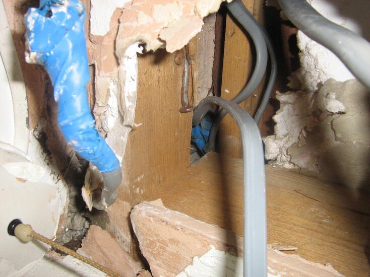

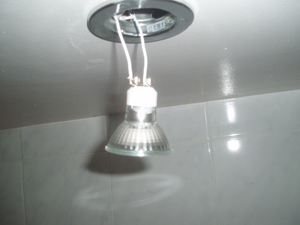

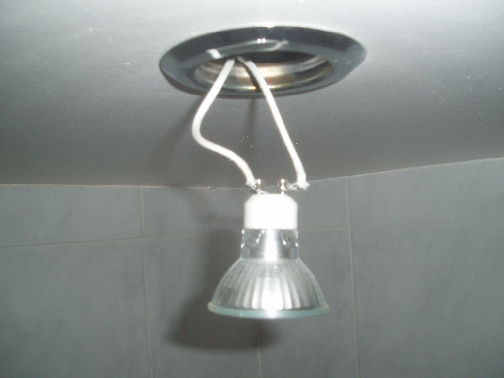

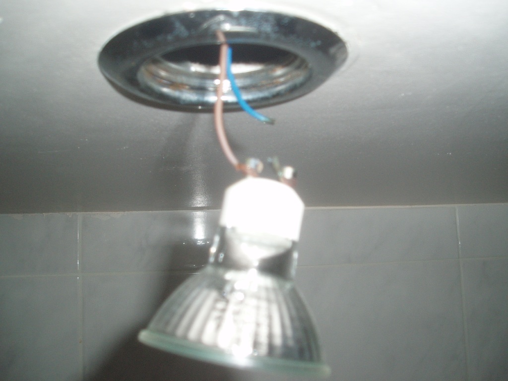

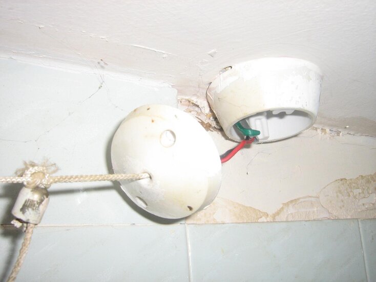

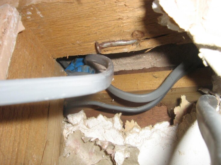

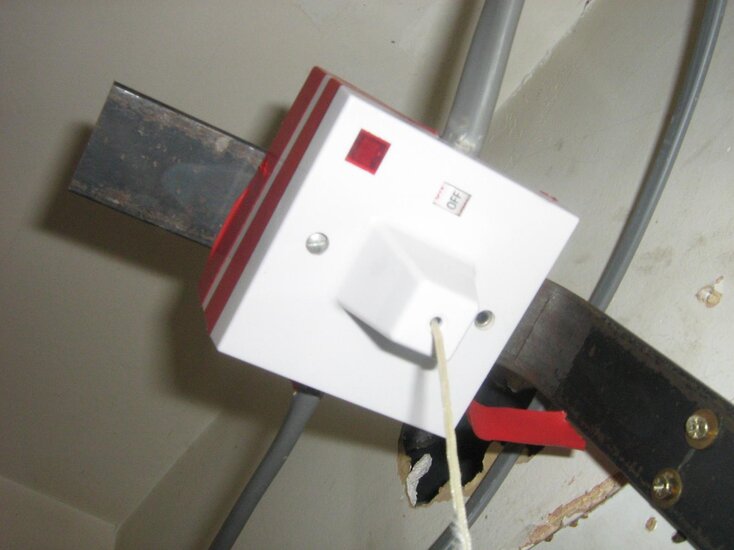

there is not a piece of paper long enough for the report. the lighting circuit nearly caught fire Saturday night. stripped down the fittings and the was lines not even twisted just wrapped round with tape. no sleeving to be seen in the 1st board and none in the socket outlets.shower pull with finger space. a few more pics of the bad stuff on the phone to upload later. will upload the list when i have finished typing it out for him it will be as long as an essay.
