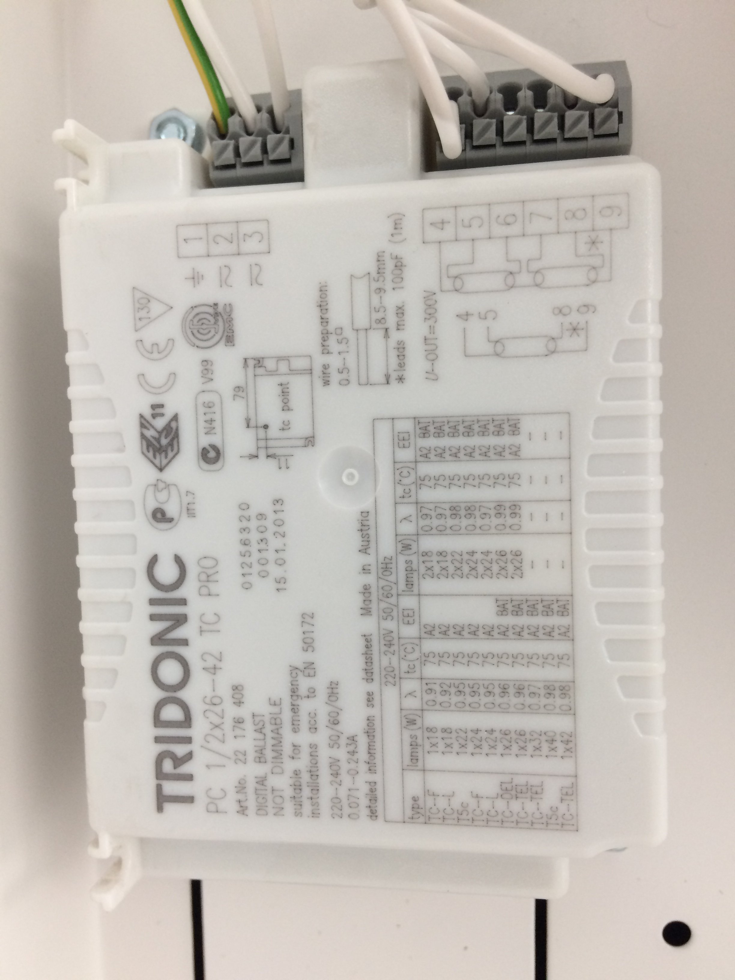

A customer has approximately seventy suspended ceiling modular lights with TL5C circular fluorescents in and is calling us out roughly every six weeks to change lamps, five or six at a time.
Averaging out gives a lamp life of about 18 months which I don’t think is too bad. No one fitting is constantly blowing lamps.
The fittings are five years old and already a few ballasts have failed.
They have asked me to “test” them to see why the lamps are blowing so frequently.
I have noticed singe marks around the lamp holder and some of the internals are showing signs of heat damage.
Other than ballast output/input and general tightness of connections and lampholder what else would you be looking for?
Or are they just reaching their age and are due replacement?

If the flourescents are being operated frequently [via the PIR's rather than manually on for long periods of time] then that will certainly reduce lamp life. I've also found though over the years that an awful lot of HF control gear is rubbish compared to the old school magnetic ballasts and operational life can be very short.
How long are the lights on for with the PIR? A very short on off time can significantly shorten the life of a fluorescent lamp. I have been told 15 minutes minimum. I have also had one site where Osram 28W 2D lamps were only lasting 6 months in 35 fittings, having the first ballast go, I changed to Tridonic and that lamp has lasted one and a half years. it was a cheep set of fluorescent fittings.

As an aside why have a twin lamp fitting fed using a single HF ballast, one lamp fails the whole fitting is down.
Ok might sound silly or too easy but the TL5C is rated for 22-42w they aren't putting in the 17w lamps maybe, no couldn't be.
Ha, no not that stupid. They’re the 40W flavour TL5Cs.
Well I say that but the ones I’ve been replacing with are 40W, went of the label rather than the old lamp. Can’t say I checked what the duds were. Now they’re in a coffin at the wholesalers.
Number three on my to do list, check all existing lamps are correct.

Well, not a very productive day.
All voltages 235-240 and stable as far as I can tell without long term monitoring. Checked every Click distribution box and at one fitting per box, with the lights on.
Did not see a PIR switch whilst there and apparently someone else had set them all to 30 mins which looks ok.
All lamps correct, of the random twenty I checked .
Did find three old fluorescents in the ceiling void that were on. These have been unplugged from the Click boxes.
This does not appear to be a deterioration issue as the maintenance records show a pretty steady rate of failure from installation.
The ballasts are Tridonic so not crap only question left is whether they are compatible with the TL5CS, which I have to call the manufacturer tomorrow.
Hopefully there’s a picture attached showing the ballast.
