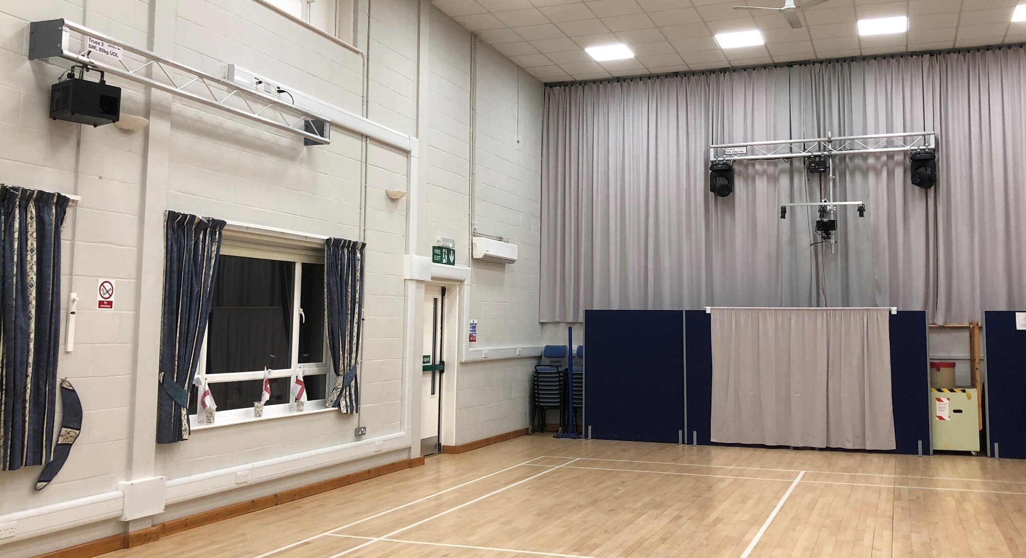

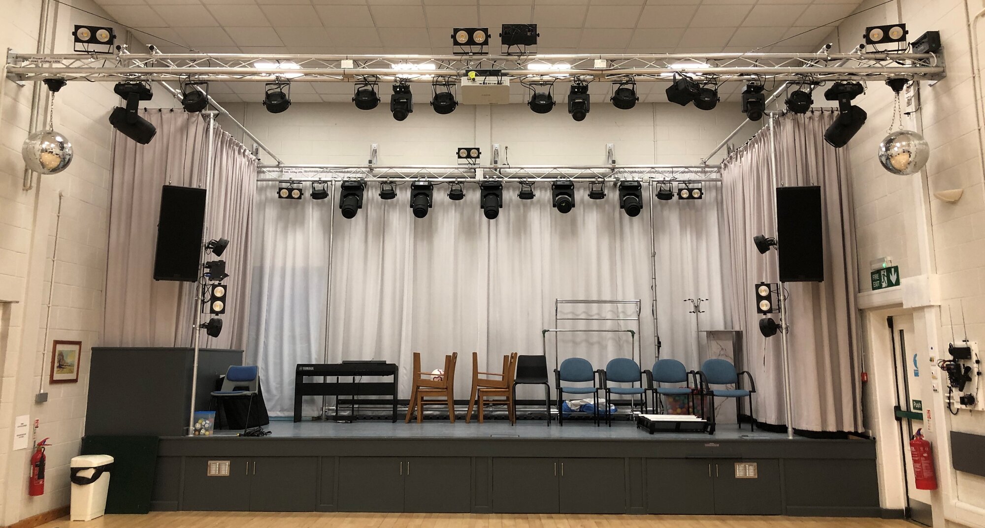

The picture I had to hand is old. Here's the rig as it is today; I'm still adding stuff. This is all new to me so any advice from a theatre/rock gig chap would be appreciated!
However - personally I'd be more concerned about how much earth leakage all those cheap fixture are dropping and how you've managed that cascade over the correct A type RCD's. ...

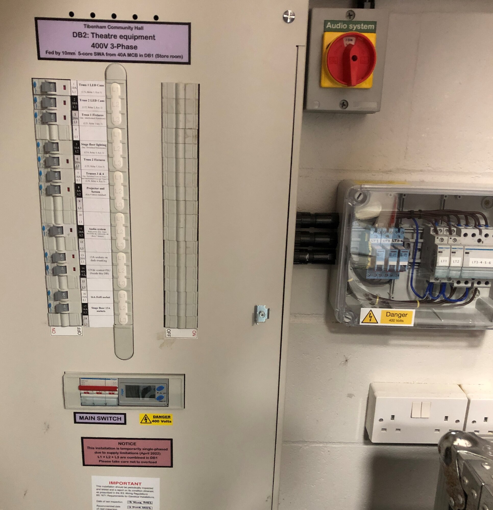

Good point. The loads are split across five circuits, each with its own RCBO.

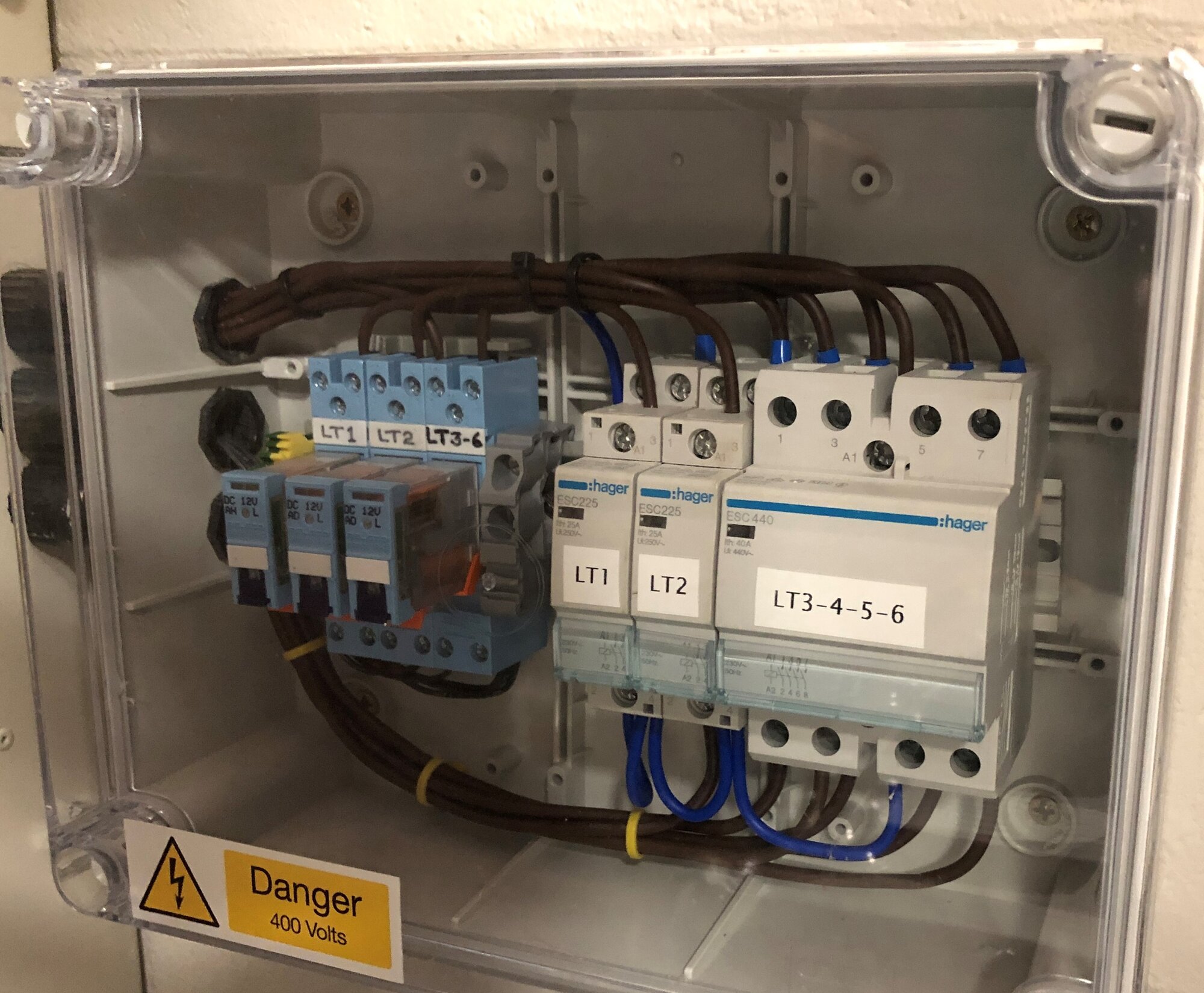

There are three keyswitches for lighting and one each for audio and the projector, so parts of the rig can be rented to users separately, at different costs.
The keyswitches operate via cascaded 12V relays and mains contactors (that was all I had in my shed - this was a voluntary job for a charity and I donated many parts. That hurt!) No doubt I'll be told cascading those relays is bad practice. Which is probably right. :)
... Who's that rig been designed for? A resident Abba tribute??!
Ha Ha! Yes, probably. I LIKE mirror balls: they remind me of my youth :) . In heavy haze they look pretty cool actually.
I've ordered ten LED 2.5 degree sharpys which will be fun for the rock and EDM gigs we'll be doing ourselves. Where would a pro rig them?
There are a couple of other trusses at the other end of the the hall. Not sure what more to put on them yet. Any ideas?
That really is some set up for a basketball court.
Getting a proper 3 phase supply won’t do any harm apart from the halls budget.

I realise you've only a small space to work in and limited funds but I think I'd be tempted to look at adding a mid truss to get extra depth and separation above stage. Move everything that's currently on the US truss to the new MS truss except for some PARS and then stick your Sharpies in a 3-4-3 pattern on the US - that way you can do some ACL looks if your style is old skool ;)
I think it's all the white that's so surprising
Ha ha! You mean the stage dressing? It took ages for the committee to let me paint the front of the stage and the side panels grey for a start. They were gloss white Dulux, threw every bit of stray light back into your face, and looked ridiculous. Next is to paint the rear exposed walls dark grey as well.
You're right - this is a rural village hall (!) and it's only happened at all because I paid for everything out of my own pocket, with the hall then paying me back as they see the benefit of having this kit, and them making money from gigs that could not have been done before. Without my JFDI attitude nothing would ever have happened. This is all a bit of a hobby for me, and something I've wanted to do since helping with lighting at school in the 70's, and it's fun. Compared with PAR cans and cinemoid, modern RGBW moving lights are amazing!
I'm not keen on putting a lot more structure in, as I can't face any more arguments with the committee about it! But your idea of the mid truss is great. I wish I'd known about that before.
I could put two or three single ali tubes running US-DS, just clamped on top of the existing trusses.
Or maybe one length of single ladder truss L-R hung off the existing US-DS rails, but it wouldn't take much weight.
Those five 350W MLs (which are beam-spot-wide zoom fittings, not sharpies) on the US truss are heavy, so they probably have to stay where they are as that's the only truss that can take the load.
What does 3-4-3 mean? Three on the stage R vertical, four on the horizontal truss, then three on the stage L vertical? Or all on the horizontal? Any of that could be done as-is, I could rig the sharpies on top of the existing US truss.
Although there are two lasers to go on top of the verticals first, to do the liquid sky thing. Yup: old skool is the way :)
What I really need is a Avolites guru to advise on the rig and set up some looks and chases in venue mode, while I learn Titan myself (I'm doing the online course now). This is all new to me :). Any Avolites dudes in South Norfolk who fancy a day's consultancy work?
