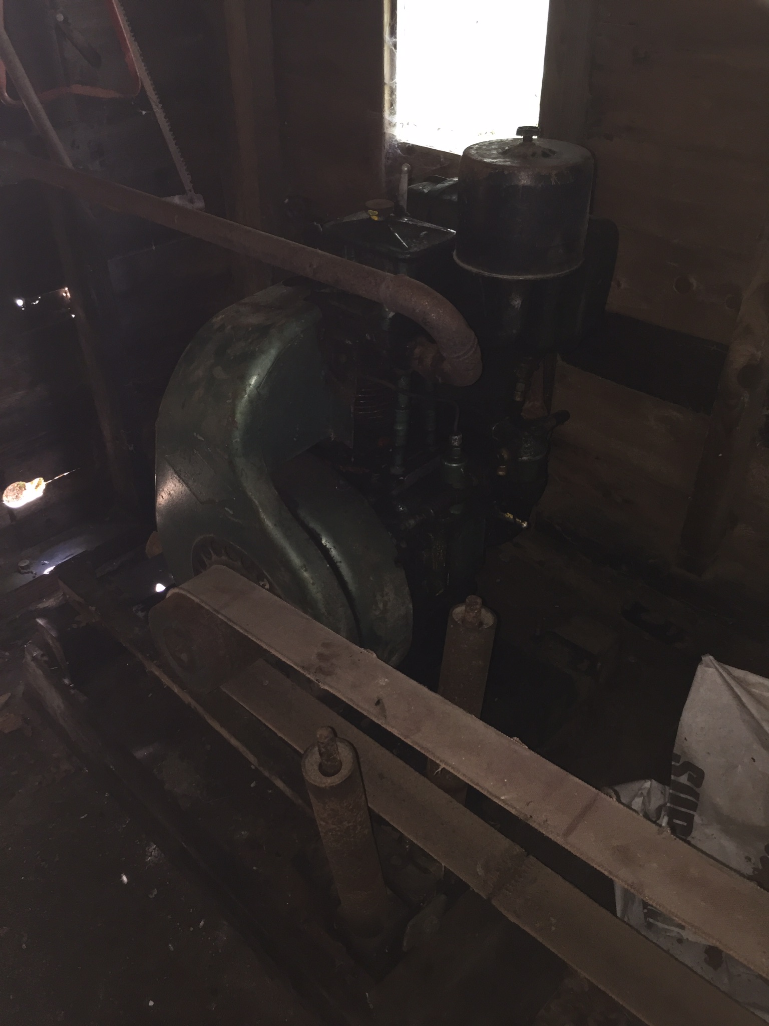

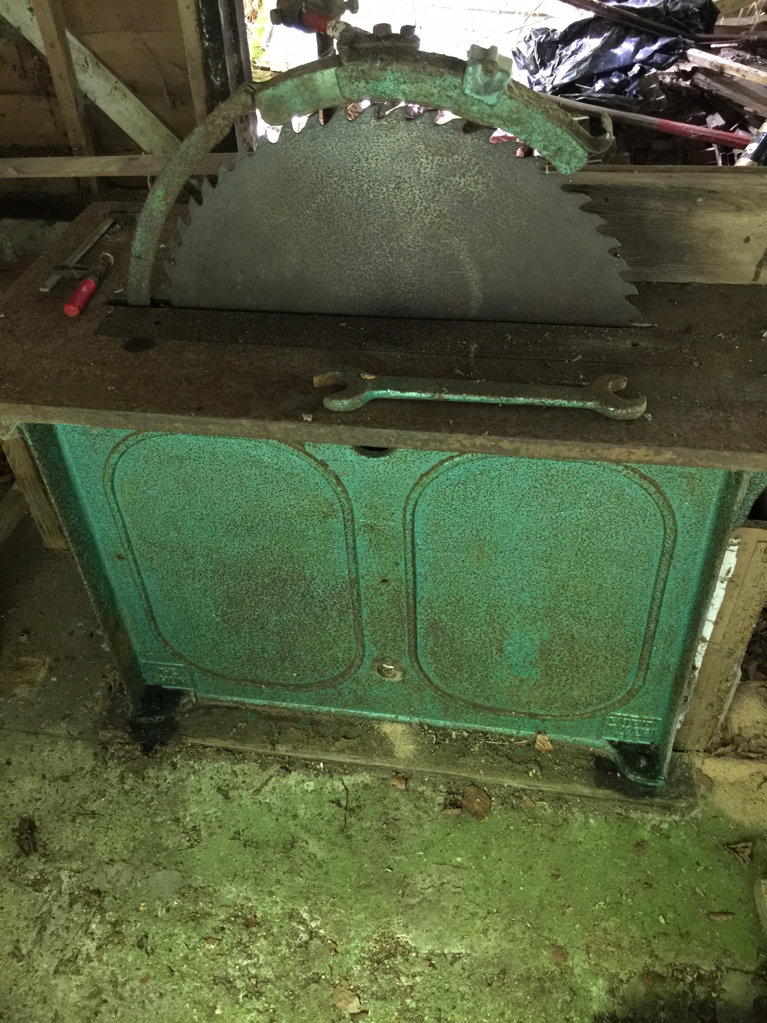

I think you will find that is a Lister :)
Please do not scrap it,these are a piece of history...me mates dad,lost his thumb on one :(
It was sold on by the vendors. I would have loved to have kept it but it would have just festered. Better it went to someone who wanted it.
