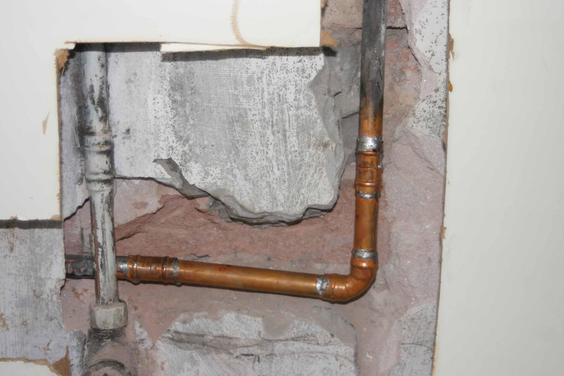

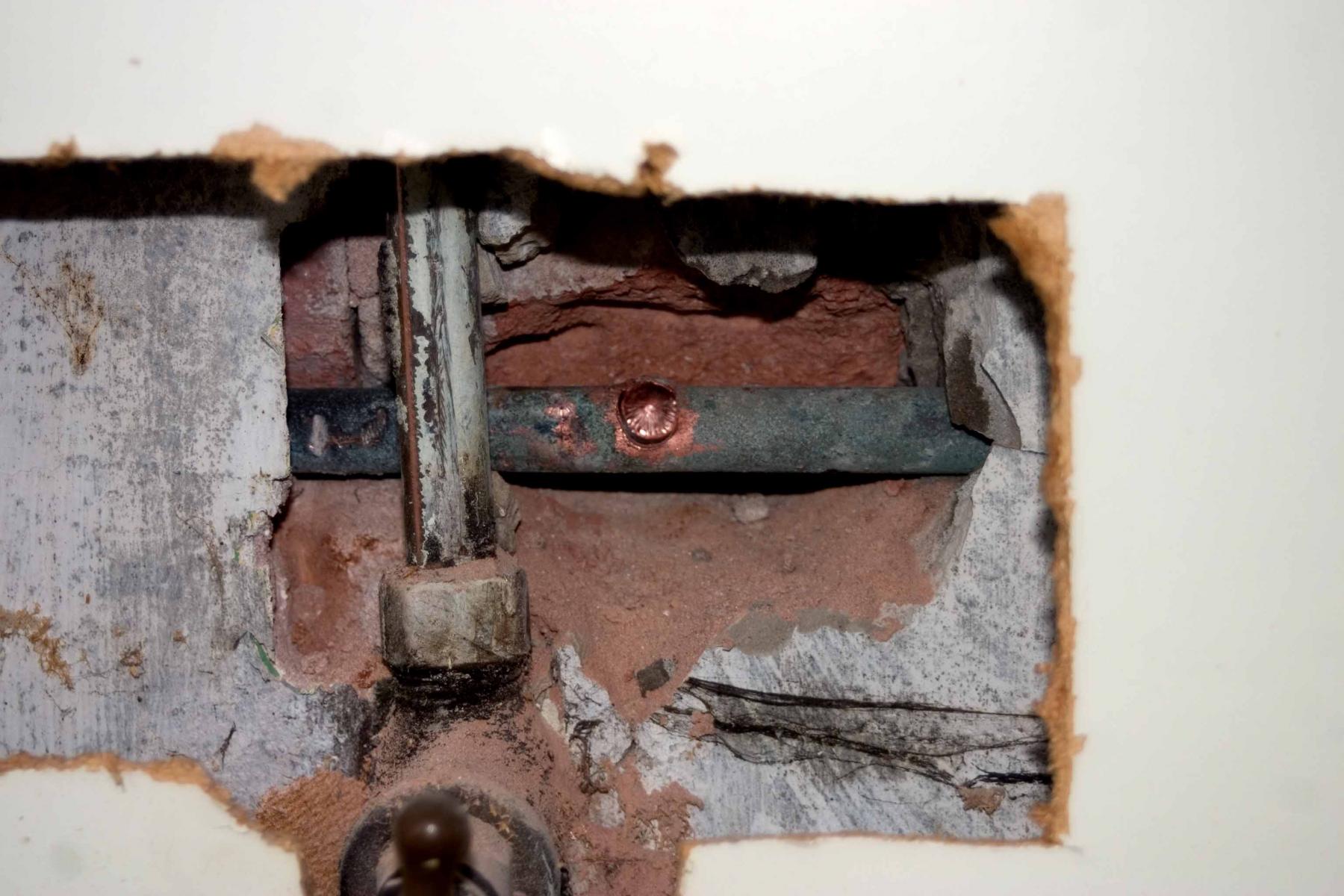

here's mine. from this morning. been going to bond water at home for ages. up till now it's has a temp. bond in garage to the gas pipe. accessed the stop tap by cutting out a chunk of the cupboard back, then drilling hole through wall to put bonding cable in. bloody gas pipe buried under render. as you can see, muggings found it with SDS.
ting was. it looked just like a nice wide mortar joint to drill through. here's the "after" pic. no cigar for neatness of soldering, but it don't leak. i've had a match to all the joints. just got to get the 10mm bonding in now.
Reactions: 1 person
I must admit I've come very close to hitting gas pipes before, they have a habit of being present when you least expect them!
