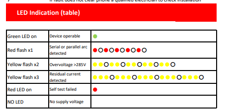

As it's hard to find online without registering I'll post the Fusebox AFDD LED codes here:
Do any of the above match what you are seeing on the one that won't reset?
You may need to disconnect the load to get it to turn on again to see the fault code!
EDIT - just read that an RCBO is holding in, which kind of answer the question I suppose.
Hi Tim, sorry I've just seen this now, thank you, I have these labels and I also stuck it on the CU in question, the issue with the AFDD was there was no way of testing at all, either with a circuit connected or without as it just wouldn't turn on.
