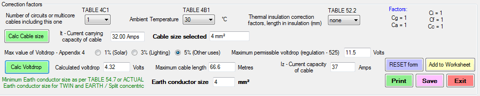

I’m trying to replace a cable to an oven. The oven is 3.6kw total connected load. It requires approximately 25m run and the cables are clipped direct to a wall. I was going to use a 2.5mm cable but when I opened the isolator it has 4mm cable in there.
I think my calculations are correct in that I can run it with 2.5? Could someone just confirm that I’m not going mad?
Thanks,
Andy
Below is cable calc for 25m Clipped direct.

Well, it’s a bit weird what’s been done. It’s currently on a 32amp with a 6mm radial. The 6mm radial then splits into two 4mm to supply two ovens.
I’m wondering if I just put two 4mm in then and put them on a single 32amp?
Ideally I like to keep the same sized cable throughout , but 4mm is so much nicer to terminate so in this situation I would probably drop down to 4mm off the 6mm if all backed up by a 32a
Ok thanks. So that’s what currently is there. 6mm cable to a junction box, and 2x 4mm going to the ovens - all backed up by 32amp breaker. That’s ok to do?
Assuming the JB is rated above 30 amps , is installed correctly and accessible for testing
6mm and 4mm cables is fine on a 32amp so long as its not running through loads of insulation etc
