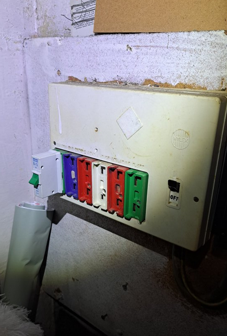

My customer asked me to change her intermittently working bathroom pull switch.
When i arrived I saw that it was a 45A shower pull switch purely being used to switch the light on and off. Wired in 1mm.
However, there was a conductor in the both the L and N in the supply side, and just one conductor in the L on the load side.
My question is, is the conductor in the N on the supply side doing absolutely anything? i know its not!! But, I just cant for the life of me figure out why it's been done, so I'm doubting myself. There is also one other conductor, just left in a wago.
The bathroom light is not IP rated, there is no RCD protection and the wiring is awful. i will obviously fix all of that, but that also makes me more worried and doubting of the strange wiring in the switch.
Can it ONLY be a PL and SL? Same as a normal switching arrangement. Perhaps they have simply left a conductor in the N supply rather than a wago. Just fancied mulling it over before tomorrow morning. Thanks :)

My very first thing was to do a global IR test, which came back as 0.45ohms L/N - E.
Various IR faults showed on various circuits. Some circuits showing more than one fault (after I had split the ring).
Reversed polarity on 4 sockets.
The main earth was disconnected to the earth rod.
No RCD protection. The existing VOELB test button doesn't work.
I fixed the revered polarity and earth.
I then delved in to the many faults and was getting no where (I'm 'reasonably' good at fault finding).
The end result is I have suggested a rewire. It is very old (imperial cable). Every where I went there was something horrendous to look at, and many DIY additions/alterations.
I have also suggested she get another electrician in for a second opinion, as she was very hesitant about a rewire (understandably), having only wanted a new bathroom light switch!!

I know.. I did feel bad. I was there for 3 hours, fixed the reversed polarity on 4 sockets, connected up the disconnected main earth and chatted to her for ages about her poor husband with dementia. Should have been £175, charged £50 cash as she was a nice old lady who only wanted the bathroom light working.
I'm going to see if I can find her a battery operated light maybe with a quinetic switch. Unless you guys have some better ideas?

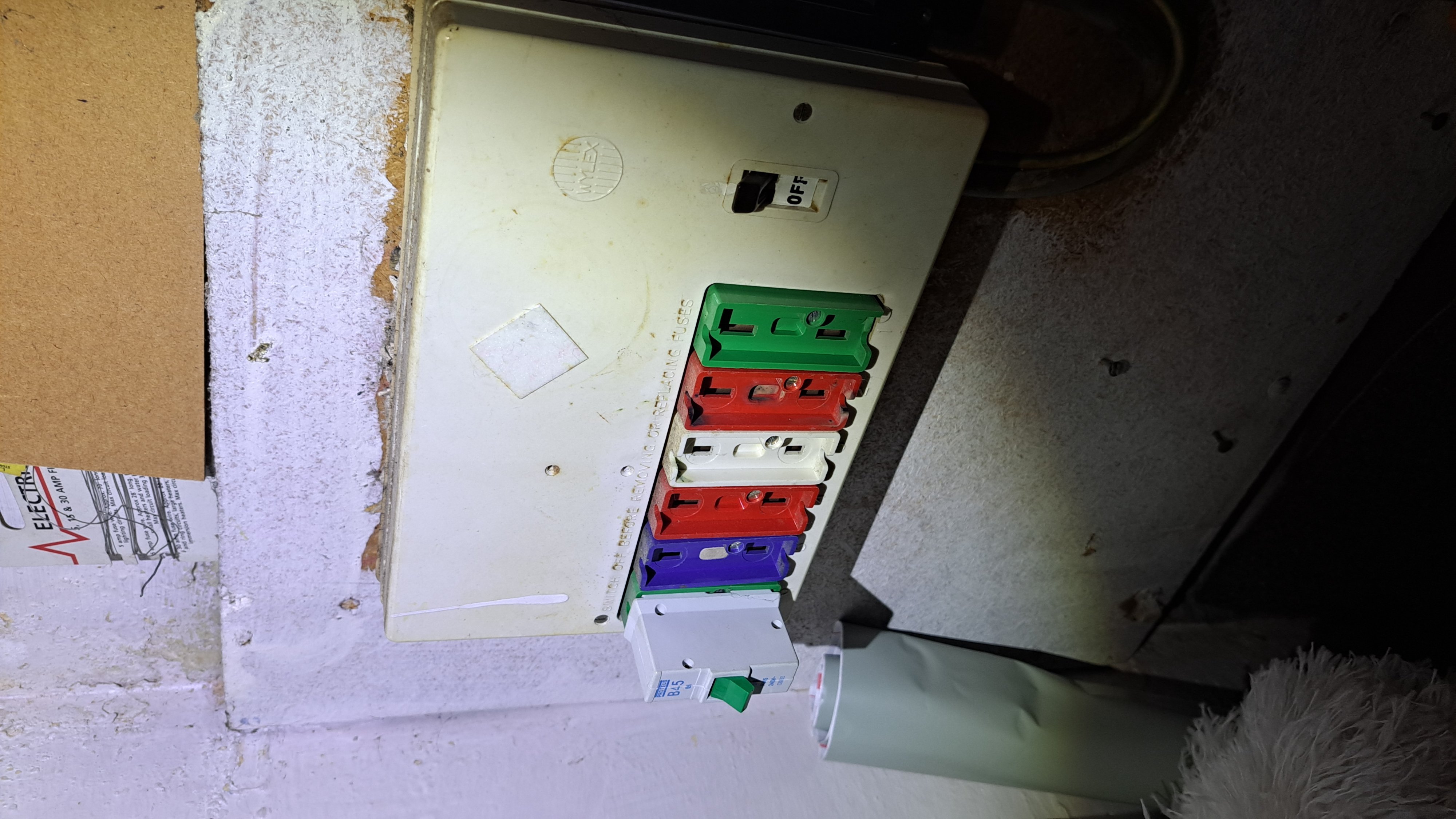

No interesting pics I'm afraid, just the one below, which I cant get to stay the correct way up!
Wow. Green terminal cover. Looks like almost a full set. Green, red, blue and white. Not including the original black ones…. Yellow missing.
I thought wow too, what is green?
