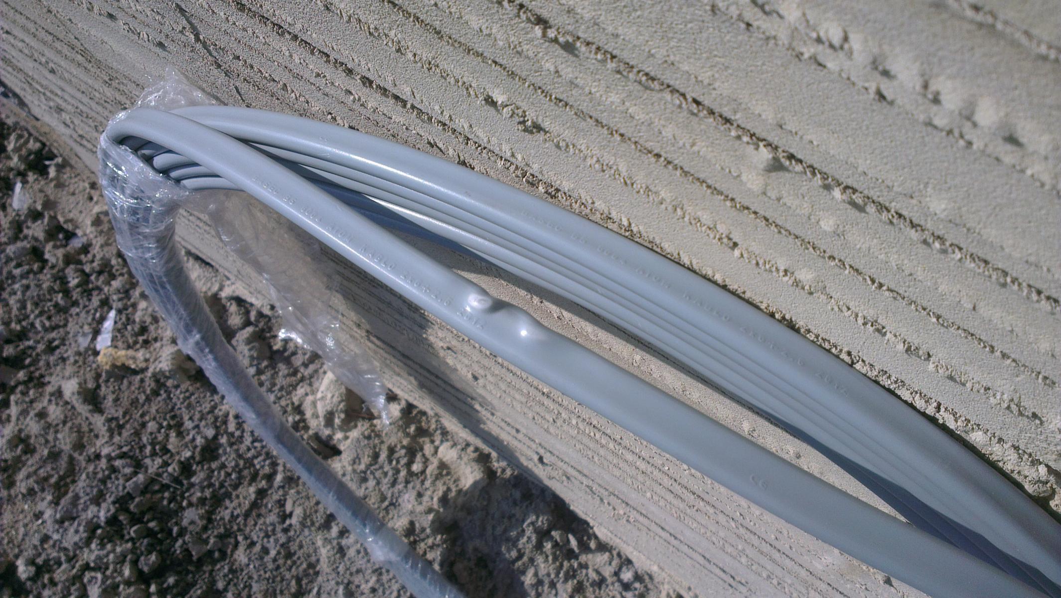

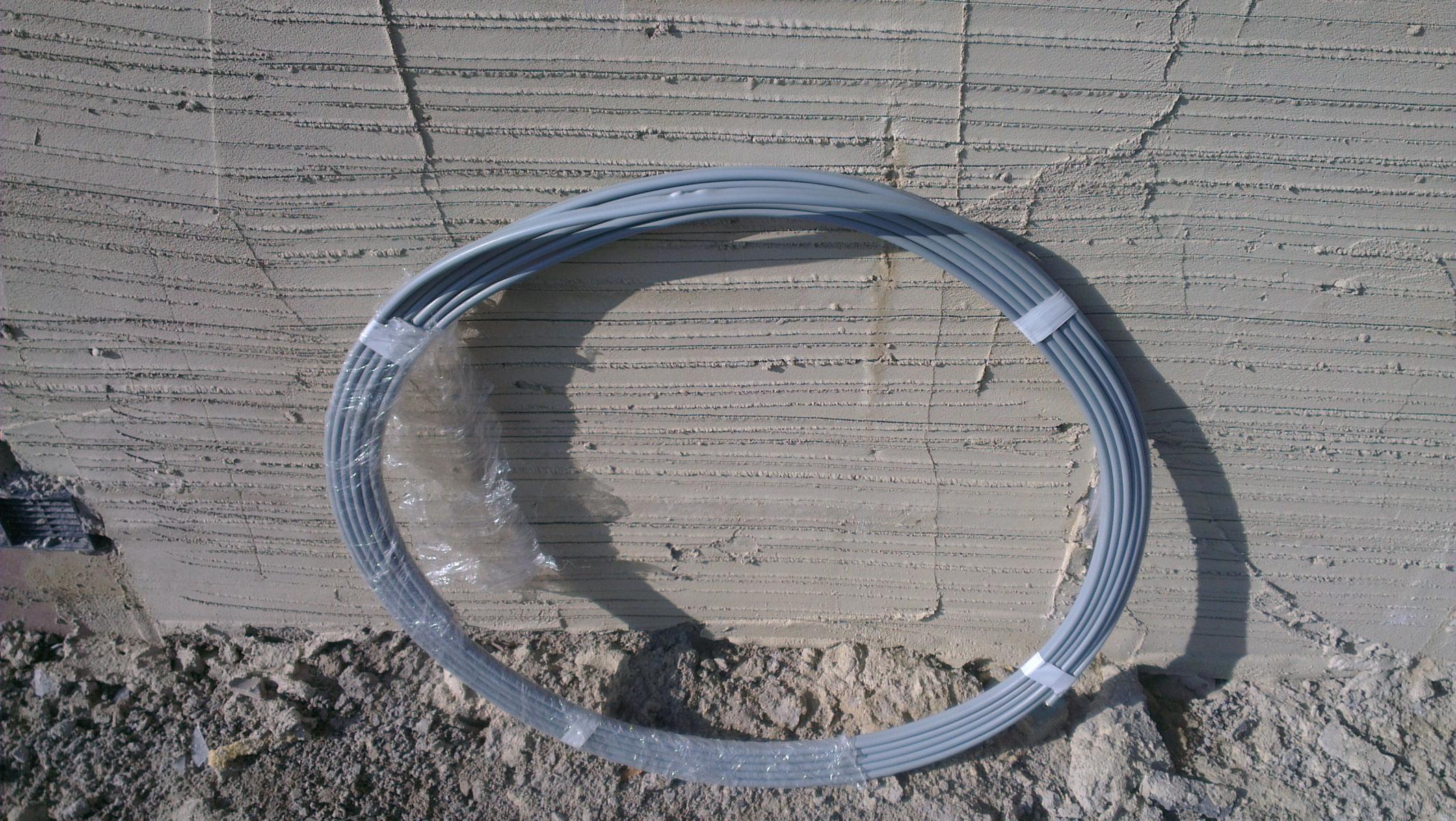

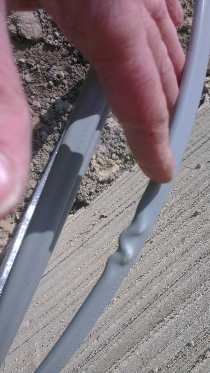

I think we have installed a dodgy BS6724 4 x 150mm SWA cable.
This cable was purchased through a national wholesaler but appears to be of a poor quality noticably the outer insulation. Problem is it was delivered to site on Friday evening, lifted onto the roof yesterday morning and installed straight away. Cable runs straight down a service riser from the roof level and goes down 9 floors to the basement where it sweeps through 90 degrees to go to the switch room. At this point the outer insulation split badly exposing the wire armouring. This morning I have visually inspected the cable throughout its entire length and noticed that every couple of meters there is a uniform score on the outer insulation approx 300mm long and that there are no visible BASEC or any embossed markings for that matter on the insulation. I am beginning to think this a dodgy cable, has anyone else come across anything similar?
View attachment photo 4.pdf View attachment photo 3.pdf
I'd be interested to hear what the supplier says
Yea so will I because the only way this thing is coming out again is in bits lol. Then it will cost another £7000 to get a crane and a road closure etc. to get a new drum up to the roof.

As above, but I guess the first question you'll be asked is why wasn't it spotted earlier in the install and could it have been damaged when it was run out. Of course, the fact it isn't BASEC stamped does leave them with very little room to wriggle.
That being said - take a look at this cut length of 16mm that I got shipped last year, I refuse to believe that someone didn't spot it when they were coiling it up for delivery!!
Amazingly it tested absolutely fine, so we just chopped that end off and used it anyway as we were up against a deadline, but still....

If there'sstill some on the roll that's also damaged then you should have a good case for a claim. It's a substantial split in the outer sheath, how come nobody noticed as it was being installed?
TBH the split only happened when the cable got to the basement and had to change direction. It looked fine as it was coming down the riser in a straight line.
That sort of damage sound like it was done when it was wound onto the reel, at a certain point on the reel something was slicing into the SWA sheath. I wonder if your supplier has discovered a damaged winding machine?
Bring the wholesalers representative to site along with their insurance assessor. Also get the project consultant, to confirm that cable damage was/is a pre-existing defect in the delivered material.

Had it many years ago. A drum of 185 3½c the serving was split at regular intervals.
The really annoying thing is we had the cable made to order to suit M&Q with 1 in every 5 armours copper.
I have experienced this type of splitting before too. Exactly the same type of split where the cable started to take a bend. It split at the bend after it was left to settle, so it might not have come off the drum like that. It wasn't rived round the corner with force, it wasn't cold on site, and it was held with appropriate cleats.
It turned out that it was some cheap Indian crap that was doing the rounds and we got the wholesaler (large national chain too) to replace it. The outer sheath, on inspection, was made out of some horrible waxy brittle stuff that just couldn't take the bending. If I remember right it had ELECTRIC KABLE written along it.
The customer was not happy and we not long after lost the work at that factory plant.
There was a rash of this a few years back where the whole countrywide supply chain got tainted with this crap. In another instance, I remember my then boss having to take a foot section of 95mm 4C ( as printed on the cable ) that he had stripped off and put 70mm lugs on, back to a branch managers desk to get a refund and a labour bill out of him.

Andy this sounds exactly like the stuff I have. Anyway had the area manager of the supplier round today and they are replacing the cable FOC and paying all associated costs with reinstalling it. And the bonus is he only took a 500mm cutting away with him. Let's hope the scrappy doesn't want to analyse the copper content :)
