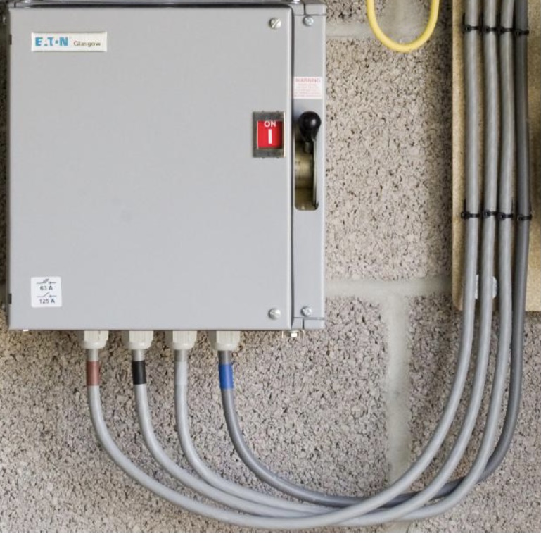

Taking the single cores through separate holes like that is a big no, no.
assuming of course that the base of the enclosure is steel and that no other provisions have been made to prevent eddy currents.
Agree with you ,but we have no other information, just a picture of an isolator with singles entering at the bottom.
Is the base plate ferrous? if so has it been slotted in line with best practice? for all we know the cable eateries may have been made in an insulating material, no info on that from the poster
Just found this on another forum… no comments on the actual pic…this can’t be right can it?
Well I can't see where the metal enclosure is earthed??
But without a picture of the entry plate it is hard to tell whether the tails have been correctly installed to prevent eddy currents
Agree that it's impossible to tell whether it's OK or not. If there is a slot between the holes or the plate is non-ferrous, it's fine. If not, it's not, although currents of this order (63A) through unconnected holes in a mild steel gland plate do not usually cause any significant issues in practice.
