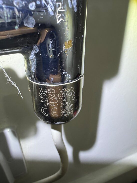

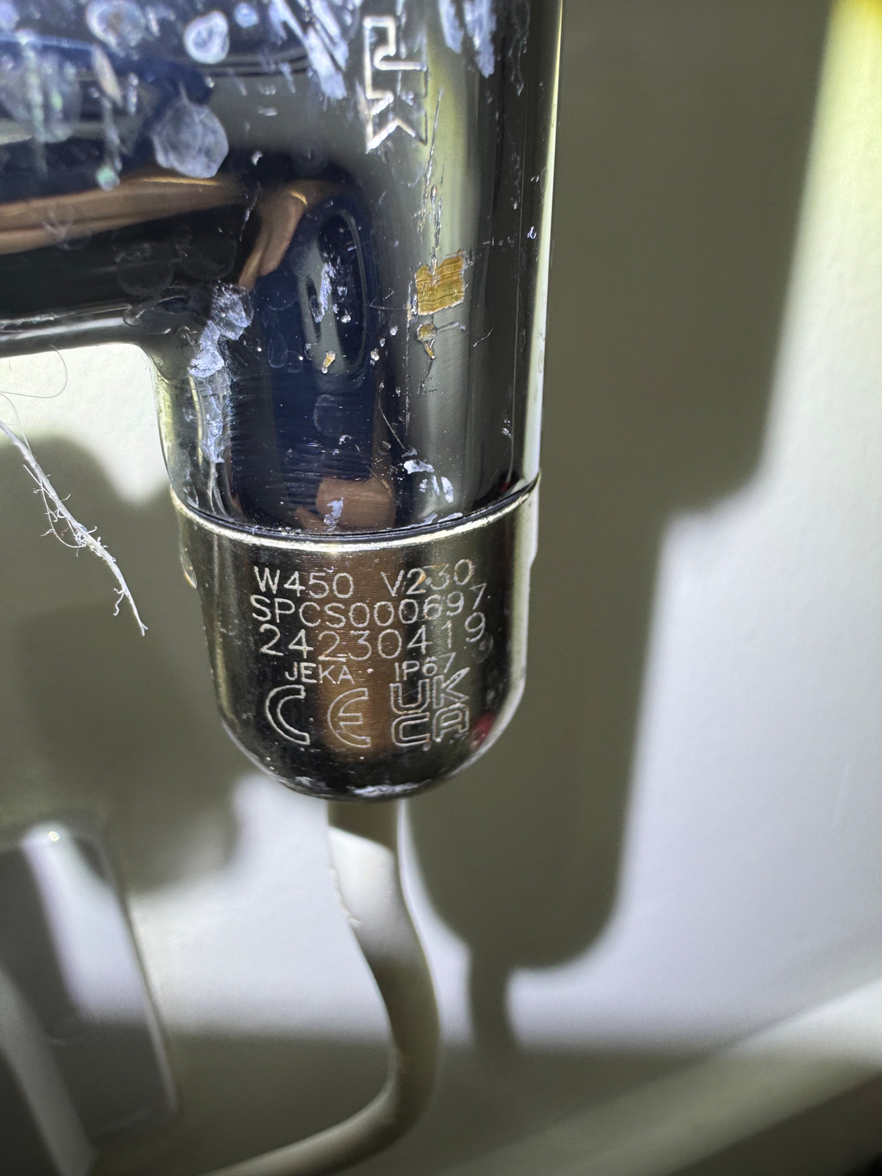

I have a heated towel rail which doesn’t have much writing on it so I’m unsure of the brand and googling the text has turned up nothing, and I was wondering what fuse I should use in the switched fused connection unit?
It came with a 13A but I suspect they haven’t amended it when installing, it is wired into the socket ring main and I think it is 450W as per the attached picture, it also doesn’t seem to work so I think the element may be faulty but the fuse is fine.
Thanks

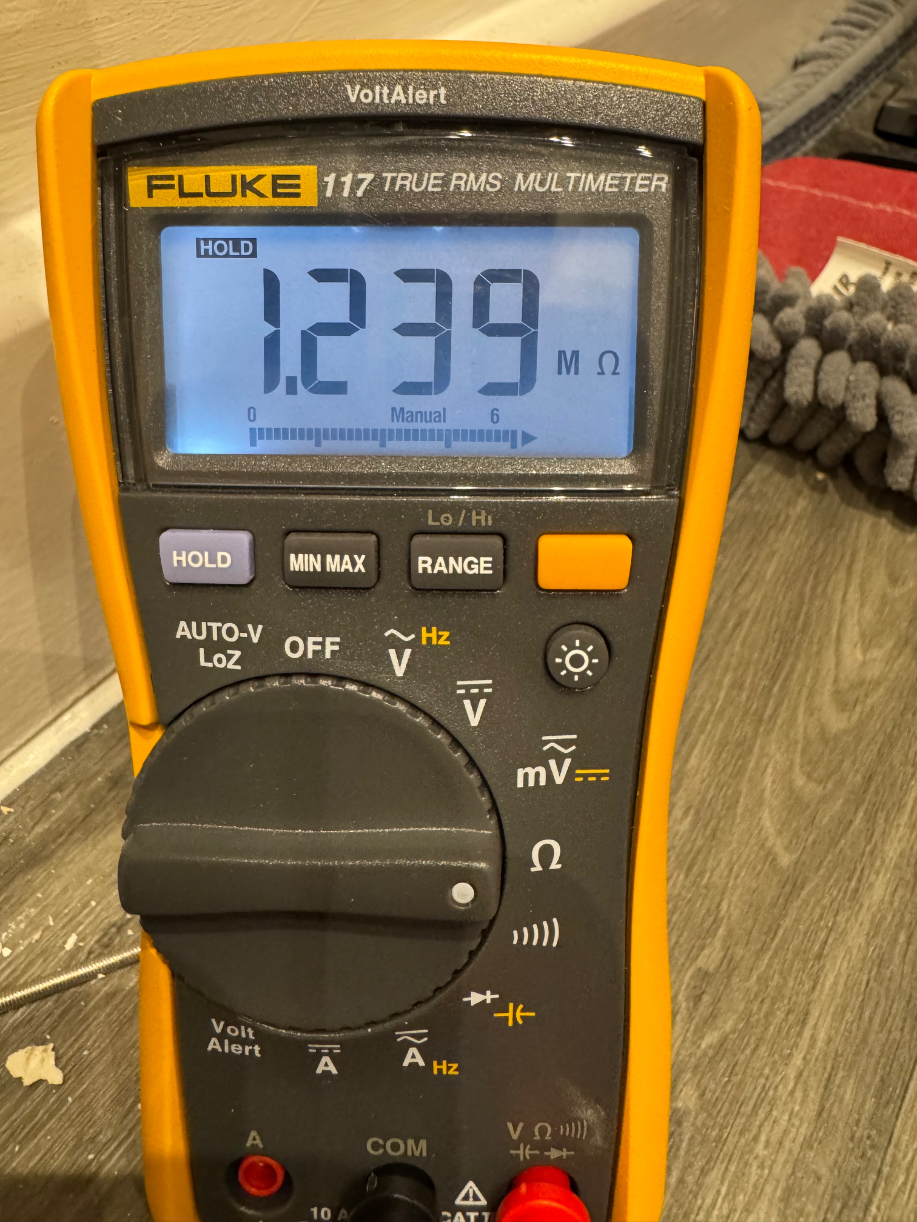

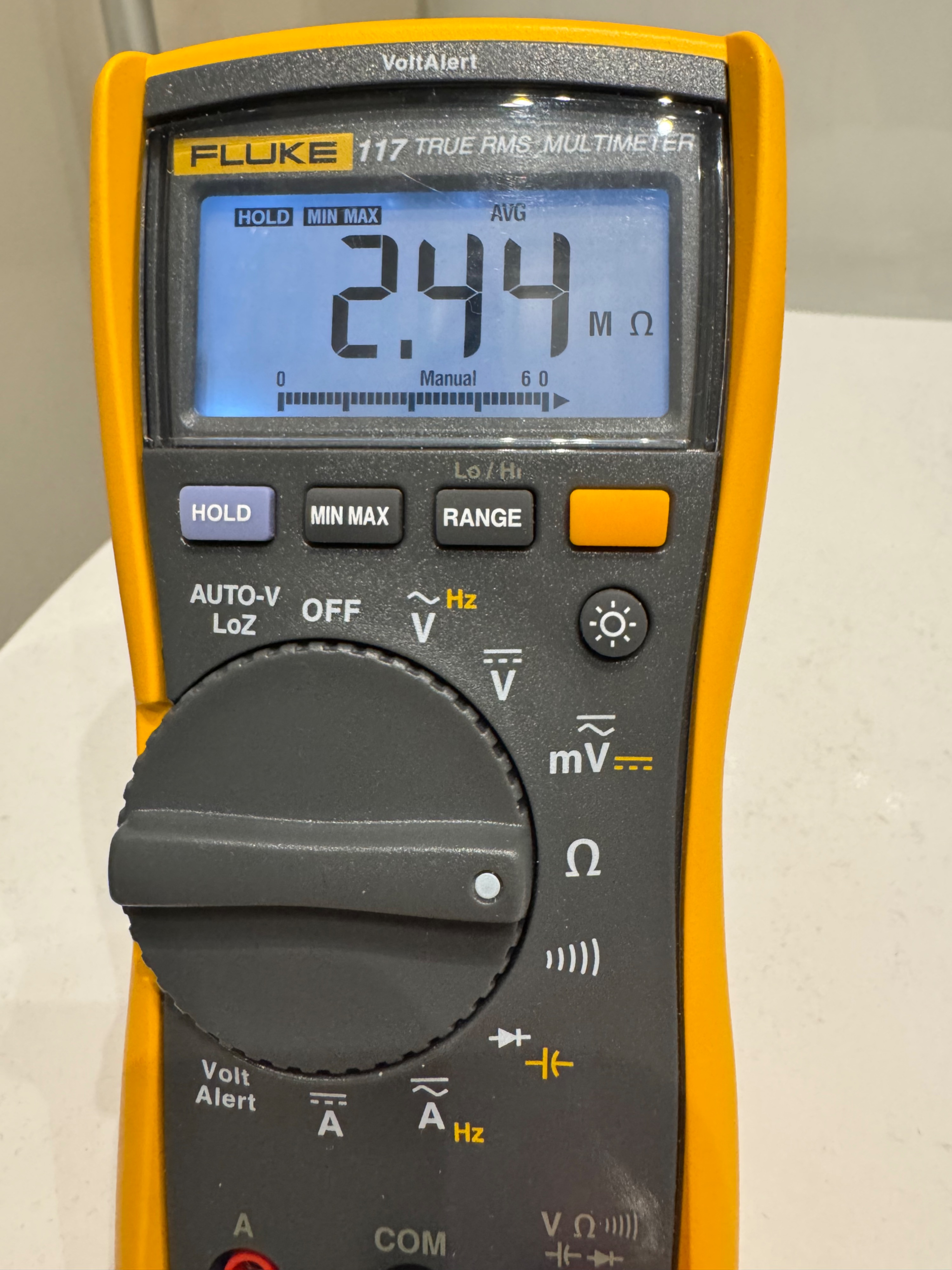

I’m not that skilled with this multimeter but the 2.44 image is Average and the second is without changing any settings and the reading rises to around 1,239 and continues, highest it got was 1,445 :(

That is saying that the heating element is effectively open circuit. 2.44 Megohms to start with, and the changing value indicating it's probably got some damp inside the element casing, maybe through corrosion.
So it's had it, and needs to be replaced with a new one - any brand that takes your fancy will do.

It's a pity because that looks a good quality PTC element from a reputable German company. Worth checking the towel rail is sufficiently full of liquid to ensure a replacement doesn't pack up as well!
If there's nothing else obviously wrong with the towel rail, you could try reporting the failure to Jeka who might offer to replace it 🤔
