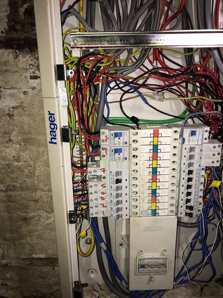

The company is in the process of dropping a gable end which requires many circuits being cut back and then reinstated.
I advised we do an EICR, although not due and for info only, to get a baseline on the installation before we start ripping it to pieces.
It was approved and despite the age and some iffy spurs it's in remarkable condition.
One thing that stood out was at the main DB and two sub boards the the ZDBs were very low giving PFCs in the range of 3-6KA
All the boards are populated with Hager two module RCBO which have a breaking capacity of 4000A.
Those in DB1 will almost certainly be under rated.
The other two DBs though have an additional 10mm earth run back to DB1 alongside the 16mm T&E sub main. Removing this brings the ZDBs up to sensible levels.

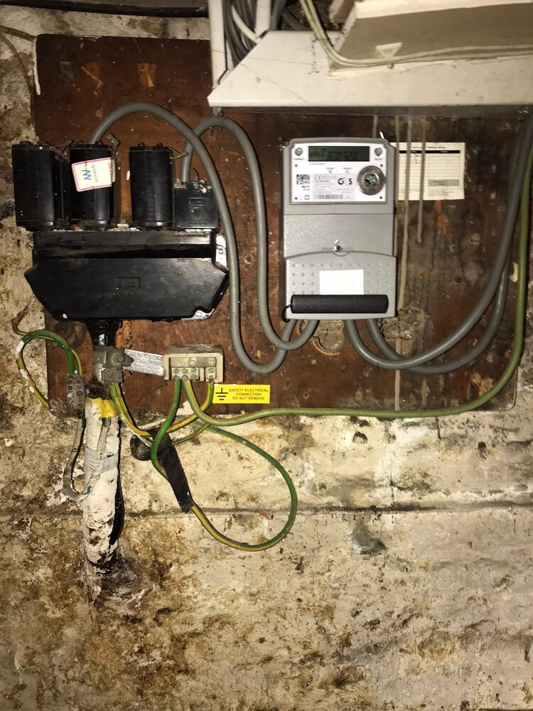

The incomer is TP TN-S with only one phase in use.
Is it likely that originally the Ze was much higher and external DNO works have brought this down, hence the additional 10mm earth?
Obviously I have no access to any previous results.
Off hand I don't know the CPC size for 16mm T&E but it might be under the 10mm or so needed for bonding on a TN-C-S supply, so that is one possible reason for the additional conductor.

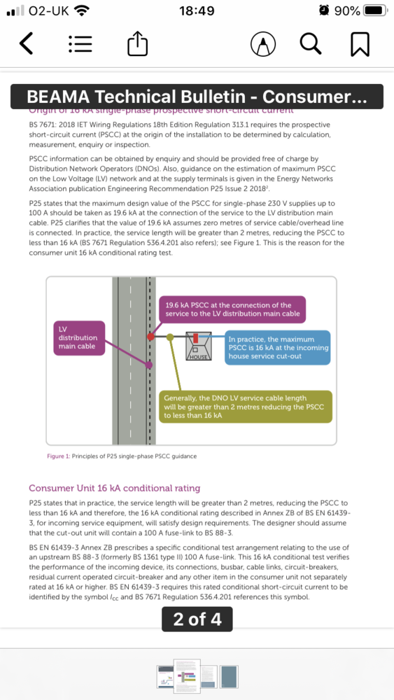

Consumer units complying to BSEN 61439-3 have a declared Ka rating of 16Ka and if it is a domestic installation then you are not even required to measure it.
See appendix 14 of bs7671.
Also see the requirements for back up protection being provided by the DNO’s cut out fuse.
As long as the let through energy of the DNO fuse is equal to or lower than the upstream devices Ka , then back up protection is afforded.
If I’m wrong about this part then I’m sure someone can correct me.
But like I said it’s not required in a domestic installation where the CU has a 16Ka rating.

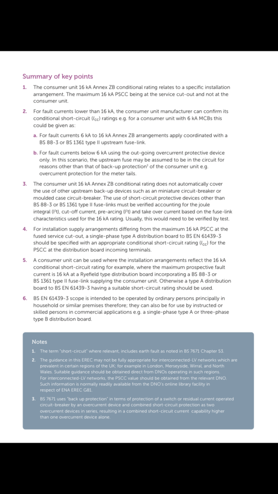

Have a read of this

Unfortunately with 100A or 80A incoming fuses, the let-through from 6kA perspective is still going to be in the order of 5kA or more, so relying on the upstream fuses isn't likely to be possible here, but you would need to know the actual fault current and fuse size/type to really check.

If, and this needs confirming, the PFC is indeed as low as I think (4-6KA) then it doesn't matter as all the CUs, if compliant with BS60947-3, will have a type default rating of 16KA as long as they are installed following MI.
Am I reading that correctly?
Yes, but it isn't a widespread yes - each manufacturer states which mcbs etc make this confirmation.
So if they state 4kA stuff is compliant with this, then you still have to do the calculations for other ratings

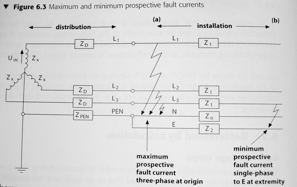

To establish the PEFC for the installation you need the loop impedance with all bonding and other parallell earth paths connected.
To establish PSCC you need the L - N or L - L loop impedance, bonding etc shouldn't affect this but I guess for TNCS it maybe might do.

I need to get a few ducks in a line before offering a solution, it may turn out there isn't even a major problem.
Firstly I need to speak with Hager to ascertain if the components as assembled conform to BS609473 and therefore carry a 16KA+ type tested rating.
There are a few mixed manufacturer MCBs that need replacing, again Hager need contacting for type compliant alternatives.
I find the additional earths curious but would not dream of removing them.

Yes, it is around 25m from the 500kVA substation and SSE told me to expect around 11kA PFC/PSSC values. I'm seeing 4kA-ish PFC and 5kA-ish PSSC but not terribly stable :(
I'm not sure what you mean by "close to the transformer will usually give you higher impedance values and lower PFC values than are actually there" though.

Is that PSSC measured between phases or from phase to neutral (replace phase withline if youre feeling modern)
I don't know the details but if you're too close (electrically/conductor length, not physical distance) to the transformer then something about the transformer interferes with the measurement and leads to a false reading.
But I've only seen that when theres a few metres of big conductor between the tester and transformer.

Thinking about that and looking at, say, the diagram in the IET design guide here:
In the event of a "three phase fault" as point (a) with a symmetric/balanced system the centre of the three line short would be a virtual neutral point due to all the currents balancing out, hence the PEN would have zero current and so the PEN impedance would have zero effect.
So the true worst-case PFC is computed from the assumption of a zero-impedance link between, say, L1 at point (a) in the diagram and the transformer star centre/ true Earth:
PFC0 = Uoc / |Zx + Zd|
However, the common thing to do is measure the PSSC L-N and double it, this would be:
PFC1 = 2 * Uoc / |Zx + Zd + Zpen|
Normally the assumption is that neutral and line conductors are the same impedance (i.e. Zpen = Zd) so we have:
PFC1 = Uoc / |0.5*Zx + Zd|
So PFC1 is under-estimating the effects of the transformer source impedance Zx in this simplified model of a three-phase transformer as 3 independent Thévenin equivalent sources and giving a higher fault current than the true PFC0 value.
But as you mentioned you can measure the line-line PFC and this is potentially more accurate as then you are measuring:
PFC2 = sqrt(3) * Uoc / (2 * |Zx + Zd|)
Rewriting this as PFC2 = (sqrt(3) / 2) * (Uoc / |Zx + Zd|) = 0.866 * PFC0
Hence PFC0 = 1.1547 * PFC2
In this case we don't under-estimate the transformer impedance, nor do we make the assumption that the PEN/neutral path is identical to the line conductors. As such this is probably the best way to measure the worst-case three phase fault current is to do line-line and multiply by 2/sqrt(3) = 1.1547
Also just to point out that if |Zd| >> |Zx| (i.e. cable impedance much more than transformer impedance) which will almost certainly be the case any significant distance from the transformer then PFC1 is close to PFC0 (since 0.5*Zx can be ignored compared to Zd) and the "worst case = twice the L-N PSSC" is a perfectly OK method for computing the max break requirements for a three-phase supply.
What I am more uncertain about is the assumption above of 3 independent sources as a model of the star-connected transformer source.

These, are the double module RCBOs in the board,cant recall who was asking :rolleyes:
Got the Electricity North West out monday to look at this dripping cutout.
This is nowhere near the worst I've come across but have been having to tidy it up just get to the earth before testing.
