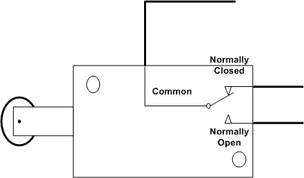

Here's a larger view of the micro-switch showing the contact arrangement.
It'll be the right hand microswitch that invariably interrupts the supply to the solenoid, so the solenoid must be fed via the N/C contact there. Therefore the common terminal on that right hand microswitch to be fed via the N/O contact on the left hand microswitch, and 230V supplying the common terminal there.

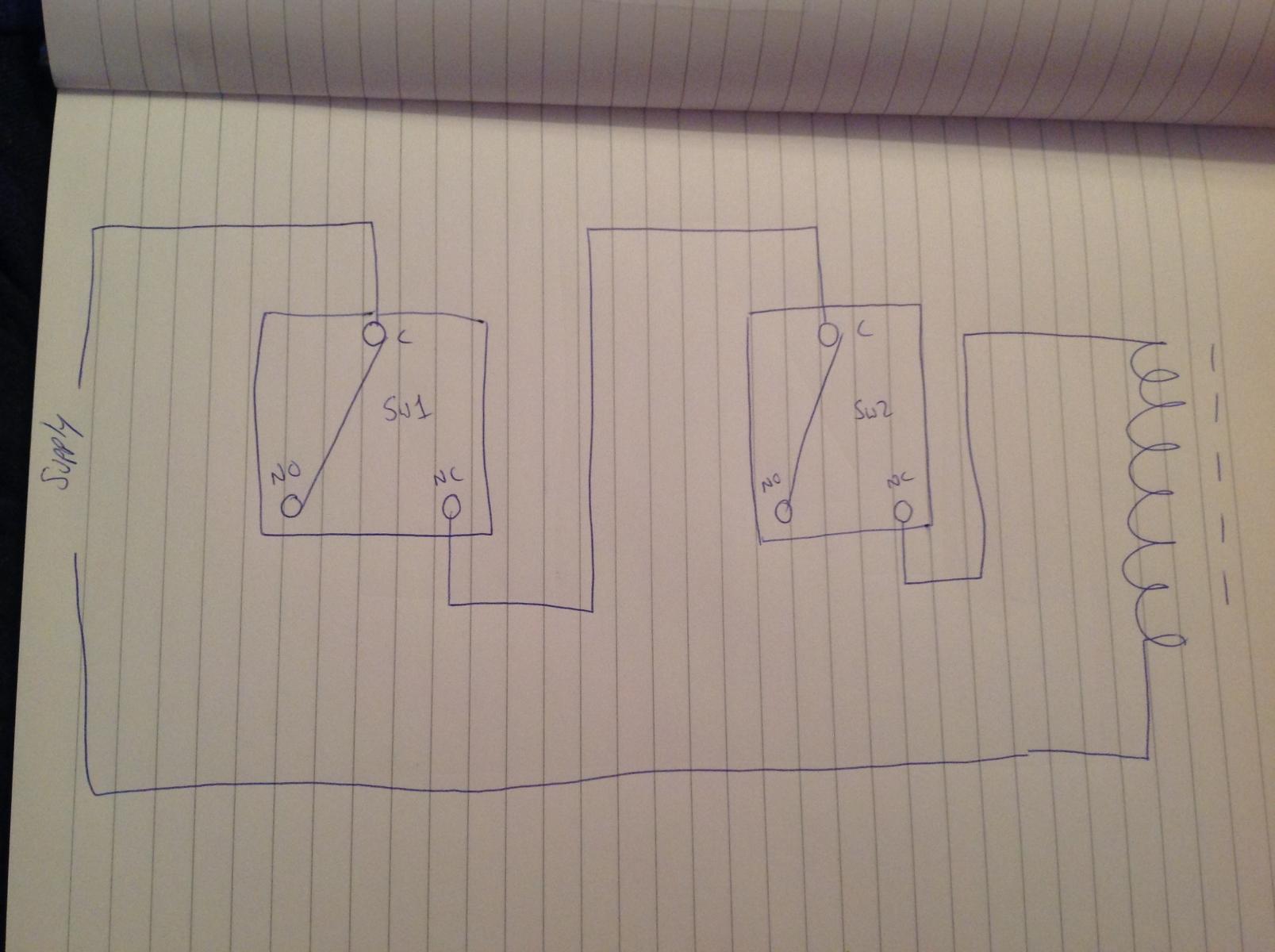

Okay, I went ahead and wired it up;
It works fine, when the lightweight Fido stands on the ramp only microswitch 1 operates and the solenoid lifts the lid on his bowl. When the overfed cat stands on the ramp both microswitches operate and Microswitch2 interrupts the solenoid supply so the lid stays down.

And as for Fido now becoming the fattie, I'd do away with 1 switch And make so the ramp is only able to knock the switch on at the weight of your dog. I.e the cat won't be heavy enough to lower the ramp to hit the switch
Lol, yeah you could make one microswitch redundant and adjust it for Fido's weight but it kinda defeats the point of the exercise which is to get you guys thinking about different switch configurations and circuits:) I'm sure now you've got a grasp of the way the system works you can come up with a circuit.
The idea will be that the dog is heavy enough to hit both switches, cat can only switch one.

Nice one Floody, an elegant solution. Well that's Fido's little problem sorted out I'll see if I can think of a new problem when I have a few spare minutes:hurray:.
