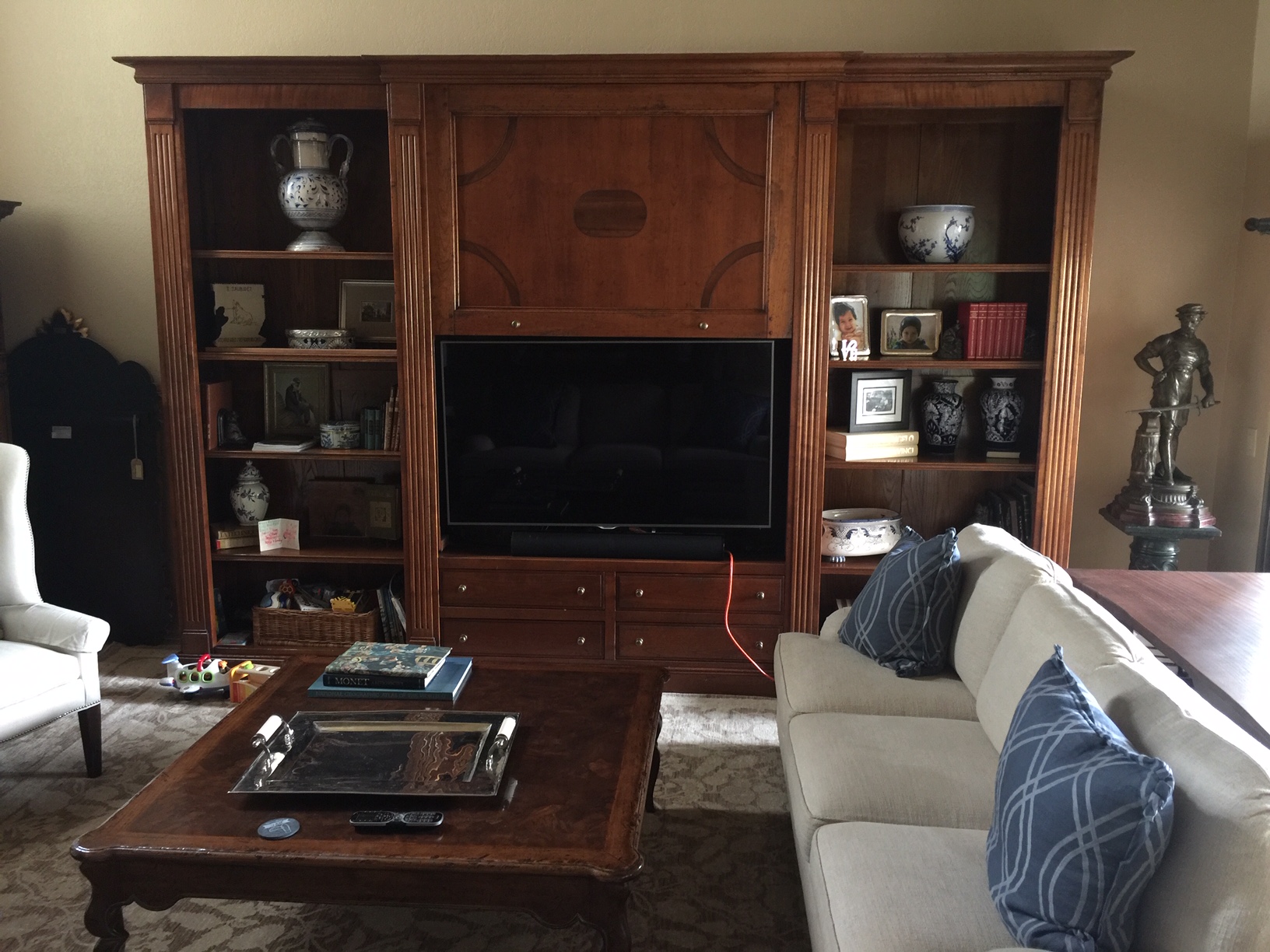

This is a picture of the living room wall opposite the breaker box outside. No power to the entertainment center. (The orange cord in the pic is a 100-ft extension cord coming from another room so we can watch TV.) There's only one plug on this wall (which is behind the entertainment center). The junction box I've been referring to is on the wall across the room opposite the wall shown in the pic.
Question: Is it conceivable the wire from the breaker box goes to the entertainment center first before it continues on it's journey to the junction box?
Or, asked another way, is it conceivable that there's a primary circuit (plugs) between the breaker box and the junction box?

YES different electricians run wires different ways so yes it very well could be run through a light first or tapped off receptacles. The good news is in 2017 NEC code book made a change for this same reason and start labeling all the first outlets. I have seen receptacles are usually the problem
Take a fan or something you can plug in at the receptacles not working and wiggle it, you might find it that way. I’ve done it
