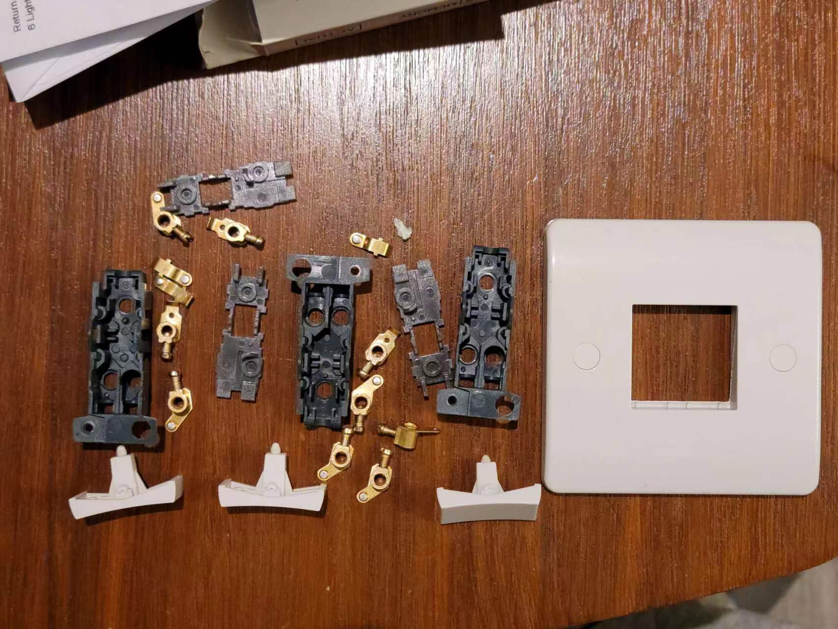

It wasn't a loose wire, so either a dodgy contact or plaster dust had got in. I had a broken faceplate that had got dropped before installation and swapped out the switch insert and no problem since then.
OK, getting plaster dust inside would explain things and is not a manufacturer-related fault.
There was one occasion when I was enjoying the possession of my newly purchased Click Mode wall switches - and water sprayed onto them by accident and I was in total panic.
Fortunately, thanks to the design, individual modules could be taken off the faceplate, and even the modules themselves could be easily taken apart and reassembled.
I dried the water out and put the switches back, and now all the 5 gangs are now in proper use.
Not sure if other series / brands could be taken apart this easily, but if your installation environment is subject to plaster dust or such, you might consider light switches that are convenient to take apart for inspection before reassembly.
Or conversely use accessories that are totally enclosed and will not let plaster dust past into the mechanism.
