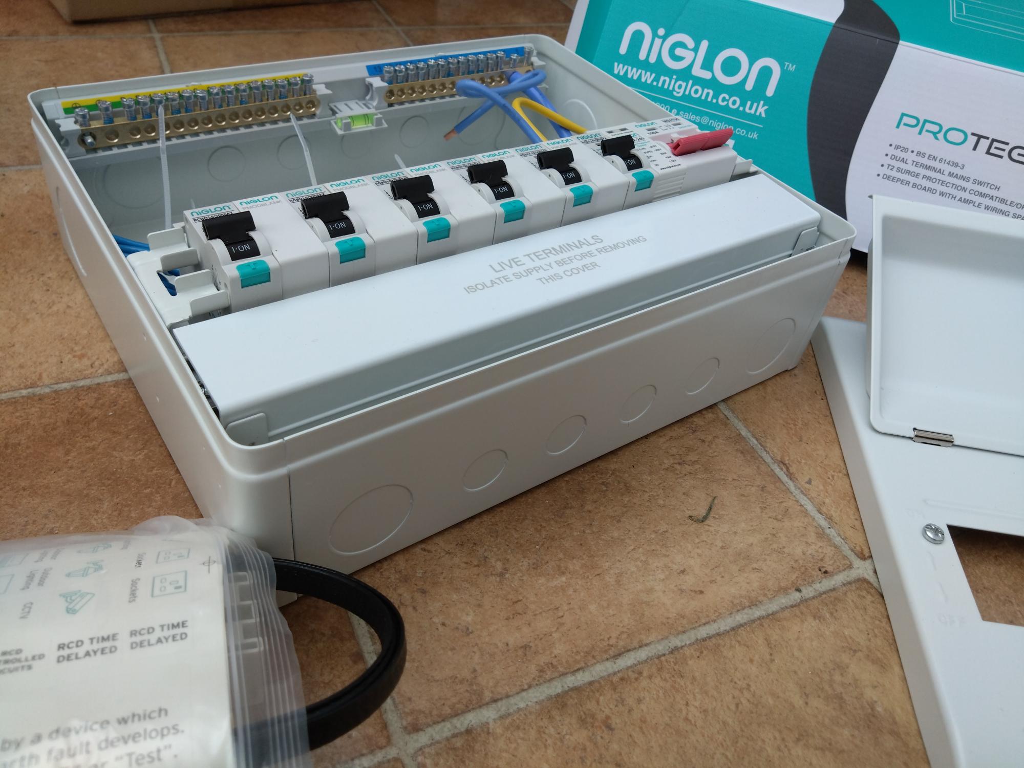

As you can see from the picture, the main carcass has a bevelled lip for the lid, so when it's on, the lid and the back part are flush - rather than the lid stick out on the sides and top, as for most other ones. This - combined with the stiff DIN rail that doesn't offer any vertical movement - means the devices are always lined up with the lid aperture.
You can see the black grommet strip at the bottom of the picture - really chunky, fits a good few mm in from the edge.

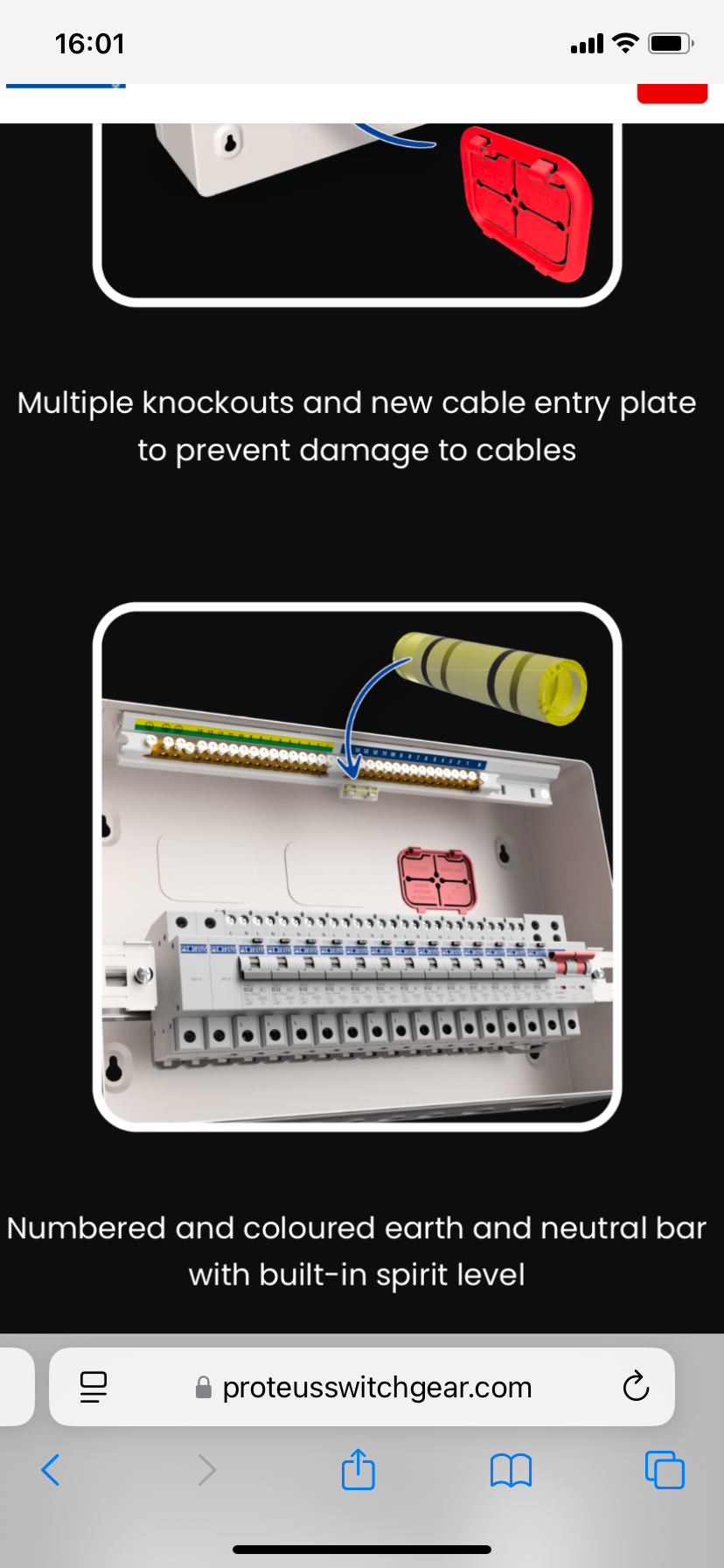

Looks a little bit like the new Proteus boards from CEF.
As in the shape of bracket holding the earth and neutral bars…. Which I have found near impossible to remove to ease tightening up a locknut on a SWA cable gland coming in the top.
Proteus lid hinge is different too. Has a spring loaded pin so the lid can be removed.

You make a very good point about the N and E bars, littlespark, I hadn't considered that. I don't think the plastic mount for the bars can be removed (maybe I'm wrong). Another mark in the negatives column, then.
They look similar-ish, but I don't think one's a knock-off of the other.

I found the proteus didn't have a lot of rear knockouts to choose from... other than the big square knockouts and the plastic clip-in grommits.
Proteus mainswitches have the double screw terminals, which is a plus...
The biggest issue i had with the Proteus is the busbar is 1 module short.... or the hole in the cover is 1 module too big.
eg, for a 10 way board, theres 12 pins on the busbar.... Mainswitch N & L, SPD, then 10 outgoing devices... thats 13 modules. The lid has a 14 module sized hole. The bar doesnt reach the end... You need to use a blank to fill it up.
